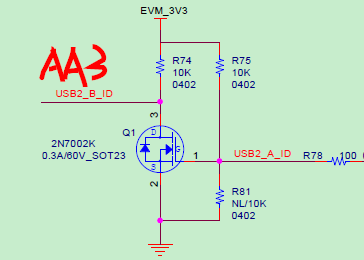

    2. The differences between EVM board and our custom board is that:
         2.1 First,in our custom board,TDA2 don't detect the level of USB2_VBUS;
         2.2 Second,in our custom board,TDA2 detects ID pin of USB port ,but we don't use PCF8575,we use AA3 as following picture.
         2.3 After I excute "USB start",I measure VBUS's voltage,it will become 5V from 0V
    Good to know the VBUS voltage is proper. Since the USB mode we trying is HOST, the ID pin is not a concern.

  • Thanks for the details and sharing the schematics.
    I am checking with the h/w expert to confirm the schematics are fine, especially the requirements to have choke and esd are properly taken care.
    Could you give some advise?And I think it's not the hardware which causes the problem,I still doubt the detection of ID pin.
  • The detection of ID pin is required only if the USB is configured for OTG mode. For Host mode functionality, this pin is not used.
