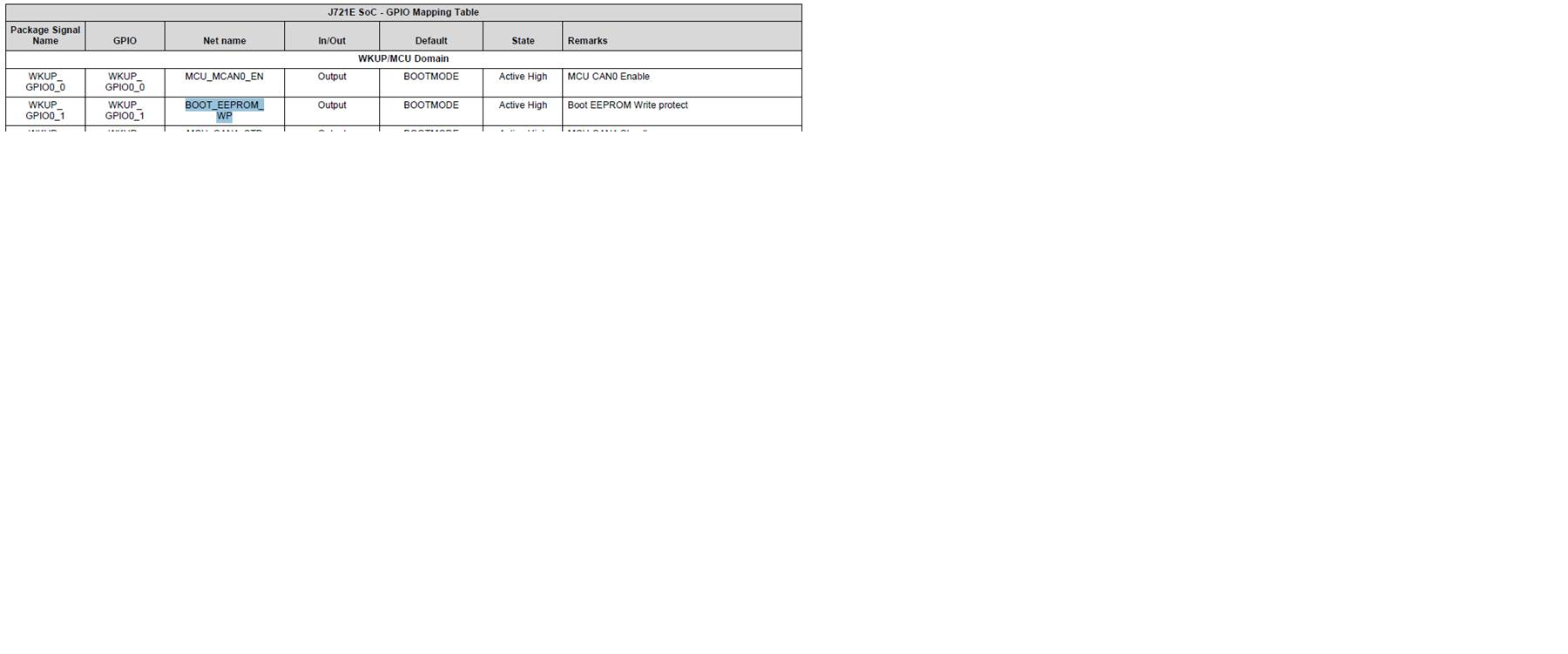

  • Hi Massimo,
    Both EEPROMs are write protected.  The configuration EEPROM protection is dip switch controlled.  The boot EEPROM protection is GPIO controlled.
    Hence you see that you are not able to read back what you write.
    Keerthy
