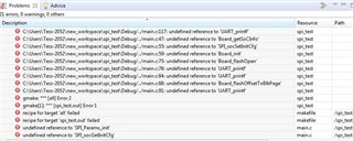

    I tried to build this example for bare-metal use case. The build failed too, but I got different errors:
     undefined first referenced
      symbol       in file
     spi_test  C:\ti\pdk_k2g_1_0_16\packages\MyExampleProjects\SPI_BasicExample_evmK2G_c66xExampleProject\Debug\configPkg\package\cfg\spi_test_pe66.oe66
    error #10234-D: unresolved symbols remain
    error #10010: errors encountered during linking; "SPI_BasicExample_evmK2G_c66xExampleProject.out" not built
    This error happens because function spi_test() is not defined for bare-metal but used in spi_test.cfg. I fixed this error by defining spi_test() for both use cases. Please see attached C code as a reference.

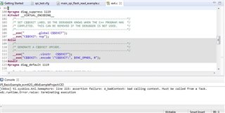

    Thanks for reply. I tried to build the code given by you , and it was built without any error . But when I am trying to debug it , it automatically moves to the exit.c file without entering into the main function. I have attached the snap shop for your reference.
    Can you please help me to resolve this issue. Thanks in advance.
    This seems to be related to TI-RTOS (BIOS). Since you're making a bare-metal application, I would recommend you to create a new project from scratch without adding any BIOS or XDC related stuff.

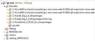

    I today  tried creating a new project from scratch for SPI Baremetal application. But I have got the following errors.
    I have included all the header files that are needed for this application.
    The CCS studio is also able to detect those header files while I'm trying to do open declaration.
    can you please help me to resolve this issue.

    I have added all the header files as u said . I have also included the file search path in linker .Even then I'm getting the same error.
    can you please help to sort out this issue .
    Thanks in advance.

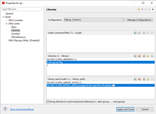

    Yes I'm still facing the same issue when i try to build the project . Even after including all the header files in include directory and also in file search path.
  • Can you attach your CCS project so that I can take a look?
  • 3326.spi.rar
    I have attached the Project file.
  • I looked at your project. You missed libraries in linker settings. The example CCS project you tried earlier has XDC .cfg file so you don't have specify each individual library. Now you're working on baremetal project without using XDC, you'll have to specify each library from the PDK that you use. For example, below picture shows how to add SPI lib.

    I tried adding all the dependent library files even then I'm facing the same error.

  • I tried creating a new BARE-METAL project from scratch using csl api's . But i got errors like "undefined reference" . I have attached the snapshot of the error , also i have attached the project file for your reference.
    This error happens because you don't have the CSL library in your linker library search path. Please refer to my earlier post.
