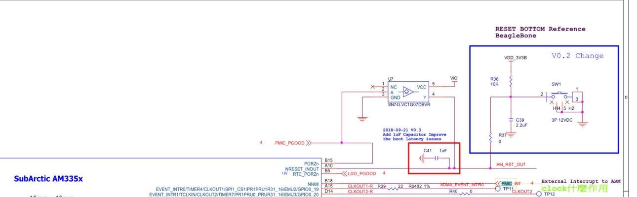

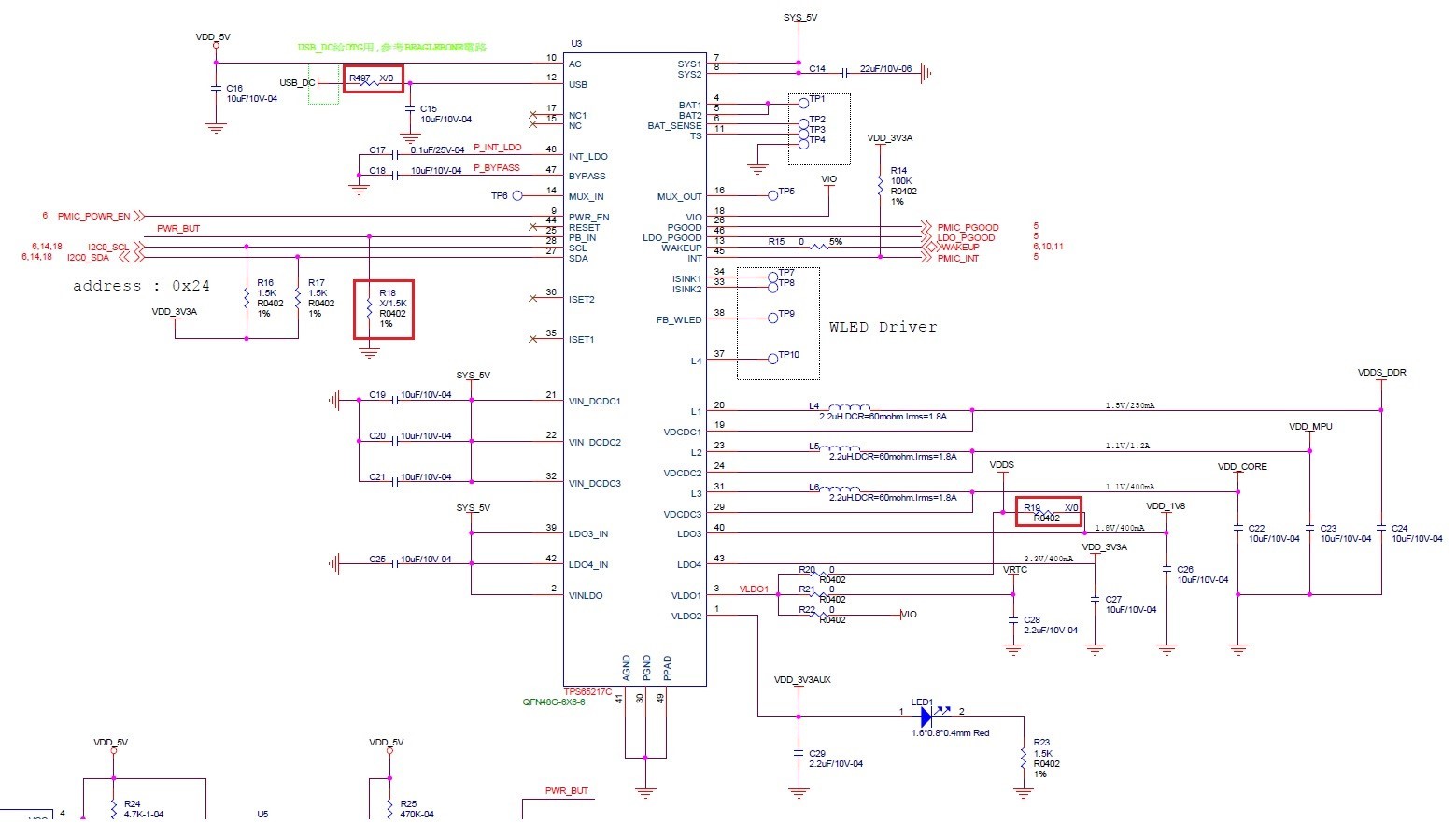

We use out custome AM3352+TPS65217 board and have the smiliar problem with
https://e2e.ti.com/support/processors/f/processors-forum/587461/am3352-high-pulse-on-pmic_power_en-during-shutdown
When send command "shutdown now", the system will intermittent unintentional reboot and we can find that PMIC_PWR_ON become high.
But from the post, it seems that PMIC_PWR_ON pluse is a normal behavior and it is not related to system reboot.
Is any suggestion to solve this problem?
It is not always reproduced and just happened in randomly.

Append schematic
HW update schematic
