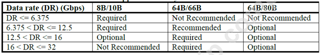

  • in JESD204C Standard doc, table say
    for data rate > 16G, 8b10b not recommended.
    Imran
  • Hi Imran,
    Supported Rx output/ Tx input rates are multiples of 62.5MSPS i.e 125, 187.5, 250 MSPS etc. For the JESD mode you plan to use, only 125 and 187.5 MSPS data rates can be used. Lane rate will be 16.5 and 24.75 Gbps respectively for those data rates assuming 64b/66b encoding is used. So practically maximum lane rate needed is 24.75Gbps.
    Though it's not recommended by JESD standard, AFE7700 supports 8b/10b encoding in this mode. Data rate of up to 184.32MSPS (slightly less than 187.5MSPS) can be used to get lane rate ~29.5Gbps (with 8b/10b encoding).
