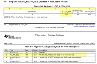

    The TXDAC is operating at either 6GSPS or 9GSPS. The DAC should not be running at 2949.12MSPS.
    I suspect there is a clock leakage from the CLKOUTp/m pins to the TXC/TXD. Could you please terminate the CLKOUTp/m pins to see if this improves the leakage of the CLKOUT spur of 2949.12MSPS? Thank you
  • Hi Buu,
    Just checking in on this. You may also tri-state the CLKOUT output by doing the following commands:
    0x11 0x10 //open PLLDIGP0 page
    0x24 0x04 //tri-state clkout
    0x11 0x00// close PLLDIGP0 page
