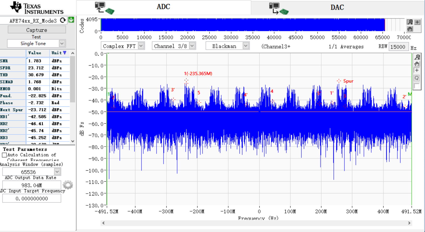

I use AFE7422EVM and TSW14J57
1 In Mode 3,capture wrong data
correct data
wrong data
2 In Mode 2,can not capture data
3 in Mode4,will never capture wrong data
Hi Li Yang,
I would like to apologize for the inconvenience. The reason that you are seeing these issues is that during the design of the EVM a couple of modes were not robustly tested on the EVM. Mode 4 was robustly tested and as you have seen will be a good mode for testing purposes as shown in the User's Guide and getting started videos.
