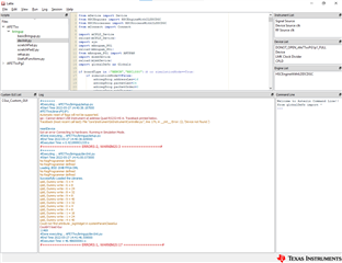

Hi Team,
   I'm new to this Latte software, i am trying to run and configure using IGUI in simulation mode for AFE7769 EVM, i have followed the instructions in user guide. need support to run simulations.
Here is my log window.
why is this error message coming in devinit.py script.

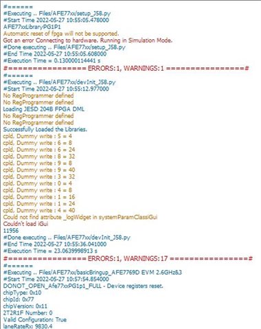

  • Hi Sivaprasad,
    This means that the USB interface driver (FTDI chip) on the AFE7769 EVM may not be installed properly. I will ask Kevin to help you on this.

  • Sivaprasad,
    When I disconnected the USB cable from the AFE7769EVM, I was able to reproduce the errors and warnings that you reported in your thread, see image below.  The messages in yellow are warnings, not errors, so you don't need to worry about them.  Couldn't load iGui error happened because as of now, AFE7769EVM still doesn't have a iGui.  We have engineers that are currently developing the iGui, but it won't be ready to the public until later this year.
    After you run the setup and devinit.py scripts, to generate the configuration file, you can modify the parameters inside the bringup script base on your own application and run(F5) the bringup script afterwards.  When you run the bringup script, you might see error like Fuse farm load autoload done didn't go high, this is because the EVM is not connected to the PC.   Other errors like Sysref to RX AB, Read 0; expected:3, Comma Align Lock Lane0: False; Please check if the transmitter is sending data and eye is good. are related to the JESD link between the AFE and FPGA, we see these type of errors all the time when running the bringup script, and it should not prevent you from generating the configuration file.  You can just ignore them for now.
