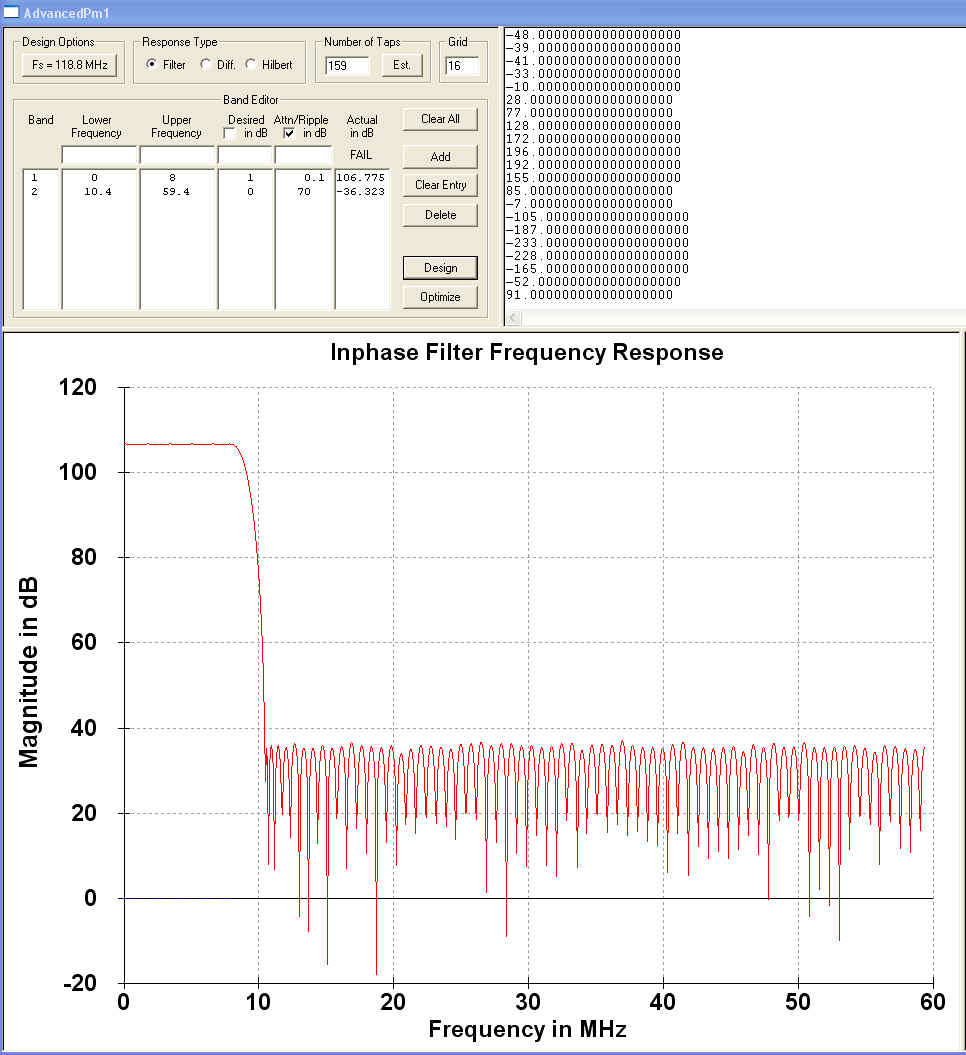

    In you example, the initial decimation was 2.5.  The suggested approach is
       split_iq 1
       rin_cmplx 0 - normally we use a real ADC and zero-pad the input
       rinf_zpad of 1
       rinf_zpad_sync 4
       cic_dec 1
        pfir_dec 5
    note: the ADC output must have good Tsu and Thi input to the GC5016 at the 118.8Msps rate
    the PFIR is designed for a sample rate of 118.8, the PFIR passband typically less than 80% BW
    the .anl file output from cmd5016 lists the valid PFIR configurations, in this case, we have 5 clocks per
    output sample, with a symmetric filter, with odd number of coefficients, 159 taps.
