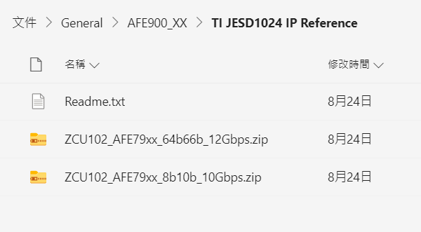

  • hi David,
    I am chaoyang's colleague. What's the secure folder you mentioned? We acquired the AFE7950 data and it looks like
    I did not see any file about zc706. Should I acquire another?
  • Hi LiehChun,
    The secure folder was only recently updated to have the ZC706 reference design, so you may not have the project if you had previously downloaded the files. Please access the AFE79xx secure folder that you were granted access to and you can download the zc706 reference design. The folder can be accessed through this link,https://www.ti.com/securesoftware/,  and will require you to sign in to your myTI account.
    David Chaparro

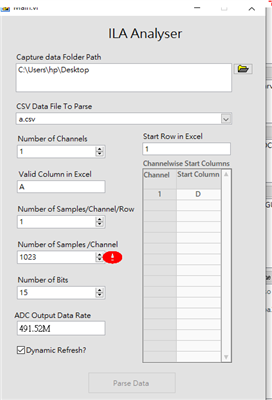

    1.What is available number of Number of Samples/Channel in ILA Analyser?

    The number of samples should be set to 1024 as this is the number of samples captured in the ILAs in Vivado. I would recommend following the settings mentioned in the TI204c-Setup document in order to see all 4 Rx channels.

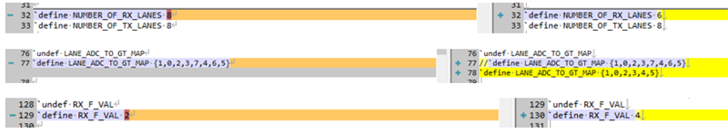

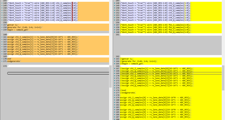

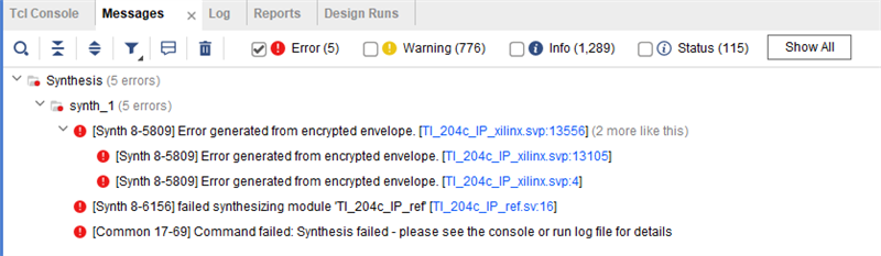

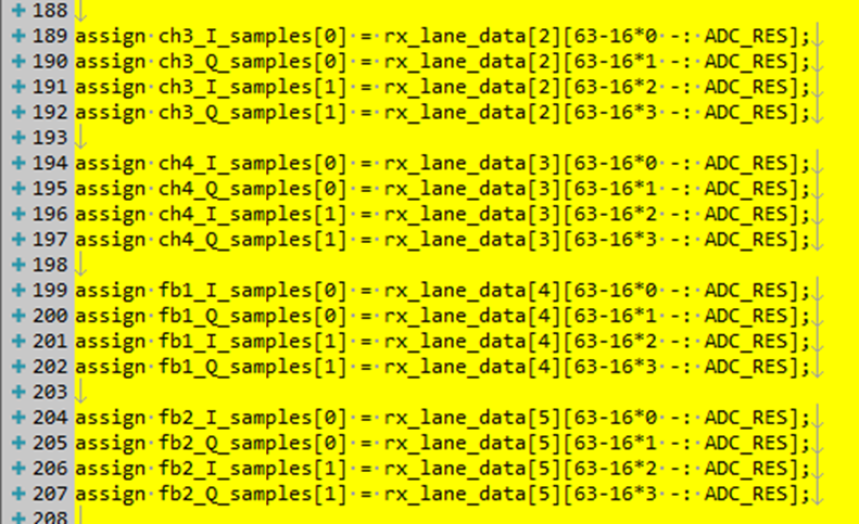

  • Hi David,
    I modify the code as following pic
    jesd_link_params.vh:
    TI_204c_IP_ref.sv:
    refdesign_rx.sv:
    Then, I get error in vivado.
    What else need to be modified?
  • Hi Chaoyang,
    Our team has just came back from the holidays. We are working on checking your modifications now.
    David Chaparro
  • Hi Chaoyang,
    I have created a reference design for the ZC706 that has both the Rx and Fb enabled. Please access the reference design through the AFE79xx secure folder. The reference design is named AFE79xx_ZC706_4T4R2F.
