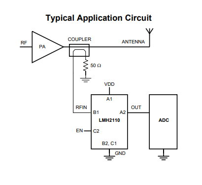

Hi Hruday,
Would you share me with a frame sketch? The customer needs to measure the frequency and the power at that frequency.
Annie
Hi Annie,
Can you please clarify what do you mean by Frame sketch, Is that a block diagram?
Hruday
Hi Hruday,
Yes, correct.
Thanks and regards,
Cherry
Hi Cherry,
I am attaching the Block taken from LMH2110 datasheet.
Currently, we don't have a reference design available for this.
Hruday
