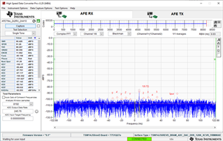

Currently I am using AFE7950EVM with TSW14J56 capture card to evaluate the ADC. I have followed the steps mentioned in user guide for HSDC pro and Latte script. In the log window it is showing that link is established between both the boards (also confirmed from the status LED D2 and D4 blinking). But while sending the tone from HSDC pro DAC tab and capturing the same from ADC tab nothing appears. In addition to this I am unable to observe this tone on spectrum analyzer.
ADC Captured data
Why this much of low output level?

    Can you confirm that the input tone to the Rx inputs is close the NCO frequency set in the Latte script, usually for testing purposes I set the the signal generator to the NCO+20MHz? For the default scripts then the RxA channel has the NCO set to 5.4GHz so you can send a 5.42GHz signal and capture the tone in HSDC Pro.  If you are using the default scripts then what you can do to test is loopback the TxA output to the RxA input and capture the DAC tone.
    Also, in HSDC Pro for the Rx channel you should set the window to Complex FFT.

  • Thanks David for your prompt reply.
    As per the below image there are two frequency set for NCO i.e. 3500 and 2600. Why this two band mentioned in the code? And what is the reason for giving
    input signal with frequency close to NCO frequency?
  • Hi Akash,
    The reason that you can program two values into the NCO, 3500 and 2600, is for when you program the Tx or Rx to operate in Dual Band mode. In this mode there will be two DUCs or DDCs per channel and the NCO can be set for both of the DUCs/DDCs. The script that you are showing is set for single band mode so the second value, 2600, is not used and your NCOs are set to 3.5GHz. Please see section 8.3.3 for more information on this for the Tx side.
    The reason that I say the input frequency should be close to the NCO frequency is because for the configuration you are showing the Rx is configured for a IBW of 245.76MHz, so with the NCO set to 3.5GHz the input frequency should be within 3.5GHz +- 122.88MHz. For testing purposes I usually set the input frequency to NCO + 20MHz.
