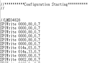

    I'm currently trying to generate dump files. Am I understanding correctly (if this is the correct behavior) that in the first step I generate a dump for AFE, and in the next step for LMK? And using SPI_Convert.py (which I always modify), I generate two different spiwrite files? Thank you very much for the clarification.

  • Hi Tomas,
    Yes, you will need to create to configuration files, one for the AFE and one for the LMK.
    One thing to check is that when you program the LMK do you see the 'LMK LOCKED' LED, D4, turn on? If not then the issue may be with the clock to the AFE. If you can also share the SPI writes that you are using I can test this on my side. Are you using the Latte script from the AFE79xx_ZCU102 8b10b reference design?

  • Hi David,
    I am using the ZCU102_AFE79xx_64b66b_12Gbps.zip design (FPGA reference designs as well as Latte scripts). I known, in the second one thread we also discuss 8b10b design but it is a parallel task.
    What is tested and works well:
    setup.py -> devinit.py -> TI_IP_12Gbps_8Lane_ConfigLmk.py in this order. Everything works well (but D4 is not turn in in this state, but D3 yes)
    Then I tried to generate SPI writes:
    1) I set the logDumpInst.logFormat=0x21 and I got Afe79xxPg1Format5.txt
    2) I ran the SPI_convert.py and I got the spiwrites_step2.py
    3)  I added the  ‘lmk.logClassInst=logDumpInst’ to the devInit script and  ‘lmk.rawWriteLogEn = 1’ to the AFE79xx script
    4) I got the a new one Afe79xxPg1Format5.txt
    5) I applied the modified SPI_Convert_LMK.py (AFENUm was replaced with LMKNUM and AFEprog was replaced with LMKprog) and I got spiwrites.py
    6) Finally, after device restart (power cycle) I tried run AFE7950_SPI.py - but without success, D3 and D4 LEDs not turned on.
     The scripts discussed above are attached here: LatteConfig
  • Hi Tomas,
    It looks like the LMK is not being programmed correctly. After looking at the spiwrites file it looks like this file contains writes for both the LMK and AFE. This means that you are programming the LMK with the AFE register writes.
    To capture only the LMK writes you should follow your step 3 and then only run the TI_IP_12Gbps_8Lane_ConfigLmk script. This should only have writes for the LMK and the number of writes should be a couple hundred.

  • Hi David,
    Thank you for the heads up - I have fixed it. However, I am still unable to achieve success.
    Scripts are located here: LatteConfig  and they shoud be correct (hopoefully). It seems that there is some error during the readback?

  • Hi Tomas,
    After looking at your scripts the issue is that the LMKNUM parameter should be set to '1'. When both the AFENUM and LMKNUM are set to the same value the first one is being overwritten.
    Please update this in your script and you should be able to program the EVM now.
    David Chaparro
  • Hi David,
    Thank you very much for your help! The configuration according to your instructions works. In fact, I will have different setting parameters (different LMFSH, DDC, etc.), but I don't see any problem with that using this guide.
    Just to mention, if someone else is trying to solve this, I had some trouble with AFE (wrong readings) in the last step, which was caused by forgetting to close Latte GUI.
