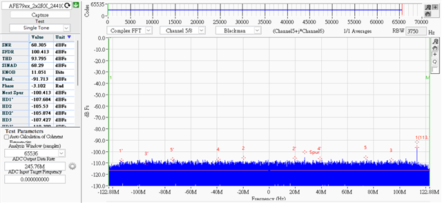

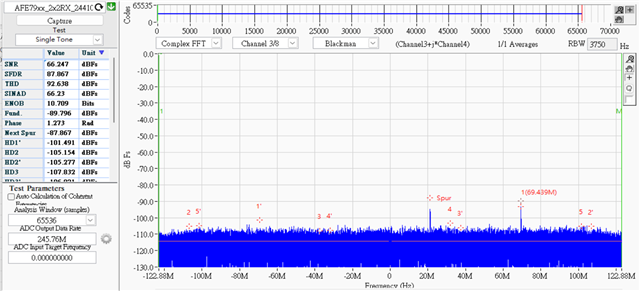

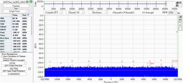

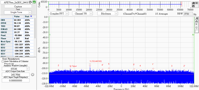

There are some spurs without any RF input when using the AFE7950EVM with TSW14J57EVM
All input is terminated.
I used only 4RX ( FPGA firmware: AFE79xx_2x2RX_24410 )
Image below is ADC output in the HSDC pro
RXA( It's fine )
RXB( 69MHz and 21MHz )
RXC( 113MHz )
RXD( -53MHz )
Latte bring up file ( OnboardClk_RX_250M )

How can eliminate those spurs ?
