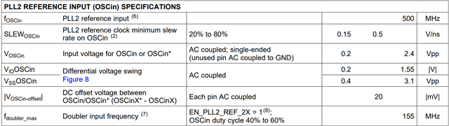

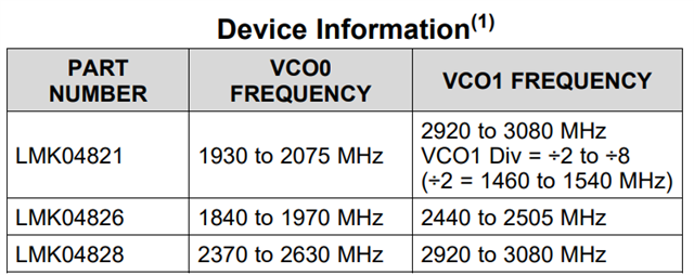

I check the LMK04828 datasheet ( page13 )
It show that 100 MHz OSCIN is allowed
And VCO can support up to 3080 MHz ( page1 )

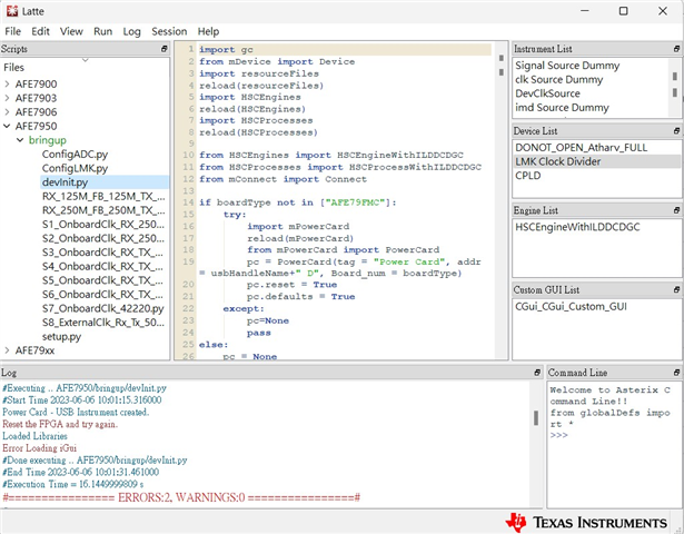

By the way, I can't load the latte igui
Is there a latest latte version ?

    Another that I noticed is that it looks like you are not using the latest version of the AFE79xx GUI. I would recommend using the latest version of the AFE79xx GUI that is available in the AFE79xx secure folder.
