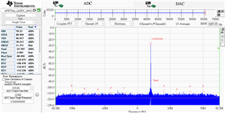

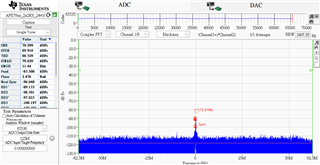

Dear TI,
I use the external clock to avoid the phase noise from AFE7950 internal PLL
When input RX equals the NCO frequency, the signal showed in HSDC pro will disappear
NCO = 4840 MHz and input RX = 4850MHz ( Normal )
NCO = 4840 MHz and input RX = 4840MHz ( Abnormal )
What causes this phenomenon ?
