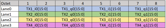

Do you have mapping table with AFE7900's LMFS vs JESD204B and its LINE DATA WIDTH(32/64BIT)?
Currently using TI-204C IP on the FPGA side, but I don't know what to do Mapping (DAC/ADC) IQ data.

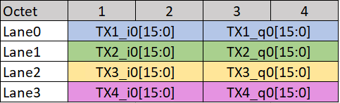

  • My JESD & LMFS mode is JESD204B/24410,I split the problem into three item:
    1.If setting TX_LN_DATA_WIDTH is 32bit,What is the arrangement relationship of tx1_i0[15:0], tx1_q0[15:0] in tx_lane_data[31:0]?
    2.If setting TX_LN_DATA_WIDTH is 64bit,What is the arrangement relationship of tx1_i0[15:0], tx1_q0[15:0] in tx_lane_data[63:0]?
    3.AFE7900 is 14bit's DAC/ADC.How do I arrange 14bit' IQ data in 16bit's line data?example:assign tx1_i0[15:0] = {I[13:0],2'b0}; or assign tx1_i0[15:0] = {2'b0,I[13:0]};

  • Hi Mingfeng,
    1. As the frame in 24410 mode is 32 bit wide, LN_DATA_WIDTH is set to 32, there will be one frame data in tx_lane_data[31:0].
    2. If LN_DATA_WIDTH is set to 64, there will be two frame data in tx_lane_data[63:0].
    3. As shown in the frame format, complex data samples at JESD interface are 16-bit wide.

  • Hi Mingfeng,
    1. If the lane data width is 32 bit then the arrangement will look exactly like Vijay shows above for 24410
    2. If the lane data width is 64 then you get two samples on a lane for each channel and the frame format will look like the below.
    3. The AFE JESD block is configured for 16 bit so the inputs and outputs should be given or received as 16 bit samples. This means that in the FPGA you should use a resolution of 16 bit.

  • hello I understand question 3, but I can't open the pictures of questions 1 and 2. Could you please upload it again? Thank you
  • Hi Mingfeng,
    Please see my previous reply for fixed images.
    David Chaparro
  • OK,I understand.Thank you
