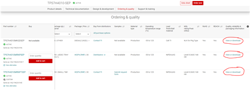

Hi Team, My customer is looking for the mass of the below TI components for planning the mechanical design of their satellite boards, Please help here.
1) TPS7H4010-SEP    Package: WQFN-30
2) AFE7903IABJ    Package: FCBGA-400
3) LMK04832    Package: WQFN-64
4) TRF1208    Package: WQFN HR-12
5) TPS7H3302MDAPTSEP    Package: HTSSOP-32
Jash
  • Hi Jash,
    The estimated mass for all devices can be found in the Material Content section of the Quality & Reliability page of each orderable device.
    From the device's web page, click "View or download" for the package option the customer is interested in.
    Then scroll to the Material Content section.
    The row that is labeled "Total" will provide the total mass of the device.

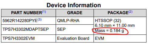

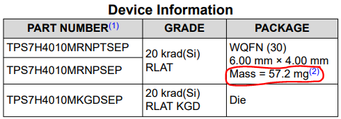

  • Additionally, the space-grade devices (TPS7H4010-SEP & TPS7H3302) list actual mass measurements in their datasheets.
