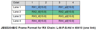

Though AFE7906 datasheet does not have JESD204B/C Frame Format for RX Chain, is it for L-M-F-S-Hd = 48410 (one link) as follows?
K.Hirano
K.Hirano
Hi Kazuhiko,
The frame format that you show is correct for LMFS 48410.
