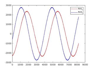

    Unfortunately, it seems that in my case, the phase alignment within the AFE7950 is not working as expected (attached Latte Log file).
    I input the CW signal into the RX channels through a splitter (1:2).
    1. NCO=4000MHz Fin=4000.1MHz
    => Phase difference between Channel 1 and Channel 3: -65.405˚ (-1816.8ns)
    2. NCO=4000MHz Fin=4000.12MHz
    => Phase difference between Channel 1 and Channel 3: -65.443˚ (-1514.9ns)
    If the NCO phases within the AFE7950 are aligned and the phase discrepancy is due to routing differences, there should not be a difference in absolute timing.
    In this case, it appears to be an issue with the lack of alignment in NCO phases between the channels.
    Could you provide information from the attached Latte Log file indicating the locations where the NCO phases are aligned?
    Please provide guidance on potential solutions to address this problem.
    Thank you.
    Park.
