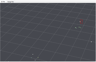

  • Hi Josh, Thank you for your response and suggestions. However, I encountered a problem when trying to save data from the Industrial Visualizer. I have followed the guide document provided by the TI team. In the beginning, we set up the CLI COM and DATA COM, then choose the demo option, and finally select 'Save UART'. Just like the image below:
    Next is to select the configuration, I get the .cfg data from the mwave demo visualizer. The results show a plot image on a 3D plot like this image:

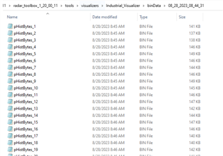

    Then I checked in the demo visualizer folder there is a binData folder, my problem is that it is difficult to understand what data is it ?
    My question is whether the above data is FFT data, if true, how do I get complex data or real data from FFT using python ?, can you help me with this problem?
    Diyah
  • Hi Diyah,
    When 'Save UART' is checked, the raw UART data stream is saved to a file. These are the 'pHistBytes' files that you see. The data is also output in TLV format. Please see this UART output data guide for more details. To make the data readable you would need to decode and parse the data. We do have an example script which parses the Out of Box demo TLVs and saves the data to a csv file which is available at <MMWAVE_SDK3_INSTALL_DIR>/packages/ti/demo/parser_scripts/mmw_demo_example_script.py.
    So with the process described above you can log the UART data using the visualizer then run that log through a parsing script (offline) which creates a csv file containing the demo output. However, I think a simpler option for you would be to modify the visualizer source code (which is already decoding and parsing the TLV data just as in mmw_demo_example_script.py) to save the data you need in whichever format you require.
    Please see the guide linked above for more information on the output data. To answer your question, no the data is not the direct result of FFT. Depending on what is enabled with the guiMonitor command the output likely contains point cloud data, range profile data and statistics. I'd also like to clarify my earlier comments on range profile, it is the sum of the log2 magnitude of 1D FFT result for all antenna. So this may not be what you are looking for. If full FFT output is required, then you will need to make some modifications in the demo source code as this is not supported in any of our demos. Please confirm, does the range profile suit your needs?
