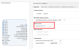

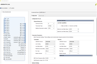

     I am using Xilinx's JESD IP.   The line rate is 4.9152Gbps, Lanes per Link is 8.
      I have the following questions:
1. The AFE chip has 4 syncin pin and 4 syncout pin. Which pin should I connect to the corresponding FPGA JESD tx/rx Sync pin?
2.  When AFE uses 8 lanes, how many JESD IPs should I use on the xilinx FPGA?       One pair of tx/rx IP, or two pairs?

    Since the Rx/Tx channels share a sync signal, on the FPGA side the JESD link should be configured as a single 8 lane IP.

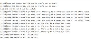

    But JESD still doesn't have a link up.  I executed this function: adcDacSync, got some errors:
    What do these errors mean?  1) Didn't pass CS State   2)SerDes Rx Lane 0 got FIFO Error. There may be a SerDes Eye issue or FIFO offset issue.
    During the testing, I only opened TXA, TXB, RXA, RXB.  So lane 0-3 has no LOS error.

  • Hi Yake,
     Yes, the JESD should come up regardless if the ADC has an input or not.  The SYNC connection to the FPGA will not matter since you set the sysParams.syncLoopBack to 'False'.
    In the IP have you released the Tx out of reset so that the FPGA is sending data before the AFE is brought up?
    For the JESD204 IP I would recommend the TI204c-IP as we have reference designs for the AFE. An email was sent to you with a request form that once filled out I can grant you access to the IP.
