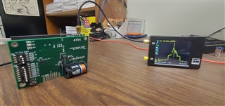

  • I was waiting for any feedback to my questions, but haven't received any.  When the output is 0db (PA_CFG2 = 0x63), a CW test with a cable connected to the TinySA gives a -25db.  See picture.  So, see my questions listed above.  The A7 changes of  slightly reorienting some parts didn't have much effect.  Also, our TX connected directly to the TI board with a cable was -9db.  And our TX connected to our RX with a cable was also -9db.

    Your output power measurements with SmartRF studio does not seem consistent: When the output is 0db (PA_CFG2 = 0x63), a CW test with a cable connected to the TinySA gives a -25db ??
    However, this sounds more expected provided that the boards are still set to 0 dBm power setting: TX connected directly to the TI board with a cable was -9db.  And our TX connected to our RX with a cable was also -9db.
