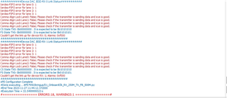

We are trying to interface TRF1208-AFE7950EVM with TSW14J57EVM and followed a bring-up presentation to interface both these devices to test the basic signal generation and capture capabilities of AFE7950. However, we are running into errors even after several retries. The error screenshot on the latte is as follows:
The process we have followed is mentioned in the presentation by the name: "AFE7950+TSW14J57" available in "AFE79xxEVM_TSW14J57_BringupGuides" folder in the secure folder.
Can you please help us resolve this error and share the reason for this error?
The log is as follows:

###########Device DAC JESD-RX 0 Link Status###########
Serdes-FIFO error for lane 0: 1
Serdes-FIFO error for lane 1: 1
Serdes-FIFO error for lane 2: 1
Serdes-FIFO error for lane 3: 1
Comma Align Lock Lane0: False; Please check if the transmitter is sending data and eye is good.
Comma Align Lock Lane1: False; Please check if the transmitter is sending data and eye is good.
Comma Align Lock Lane2: False; Please check if the transmitter is sending data and eye is good.
Comma Align Lock Lane3: False; Please check if the transmitter is sending data and eye is good.
CS State TX0: 0b00000000 . It is expected to be 0b10101010
FS State TX0: 0b00000000 . It is expected to be 0b01010101
Couldn't get the link up for device RX: 0; Alarms: 0xf000
###########Device DAC JESD-RX 1 Link Status###########
Couldn't get the link up for device RX: 1; Alarms: 0xf000
AFE Configuration Complete
#Done executing .. AFE7950/bringup/S1_OnboardClk_RX_250M_TX_FB_500M.py
#End Time 2023-11-27 11:44:12.372000
#Execution Time = 33.5499999523 s
#================ ERRORS:18, WARNINGS:1 ================#
SPIA has Not got control of PLL pages
Couldn't get the link up for device RX: 0; Alarms: 0x0
Couldn't get the link up for device RX: 1; Alarms: 0x0
