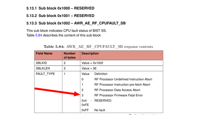

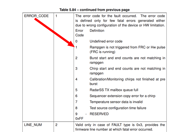

We used 4-chip cascaded 2243 hardware designed by ourselves to collect data. Now during long-term operation, we found that 2243 suddenly did not send data after running for a period of time (we have used an oscilloscope to confirm that 2243 does not send data, and the trigger signal received by 2243 is normal) . Check the program log and find that 2243 sends an asynchronous signal and reports an error. The signal type is AWR_AE_RF_CPUFAULT_SB. The specific error is as follows
FAULT_TYPE is 0x03
ERROR_CODE is 0x01
LINE_NUM is 0x07fd
FAULT_LR is 0x453c
I want to know why 2243 suddenly issued this error report, and how can we locate and troubleshoot this problem?

  • Hi Han,
    I see that HW trigger pulse is provided by the FPGA.
    Could you probe to this HW trigger line and check if interval and width of pulse is constant across for long enough time period (until you get this error msg from AWR2243)? Try to probe this line very close to AWR2243 boundary.
    Are you using single point of HW trigger from FPGA to all AWR2243 devices? Wiring from FPGA to AWR2243 are same and short (in length)?
    Jitendra
  • I confirmed our hardware design, and the way the HW triggers the wiring to the 2243 is exactly the same as the TDA board, and the wires to the 2243 are of equal length. Also, we measured the quality of the trigger signal and it is normal, the pulse width of the trigger signal is also fixed without change. Only the period of the trigger signal has not been determined yet, and there is a possibility that it is above/below the set value.
    Is it possible to localize the problem?
