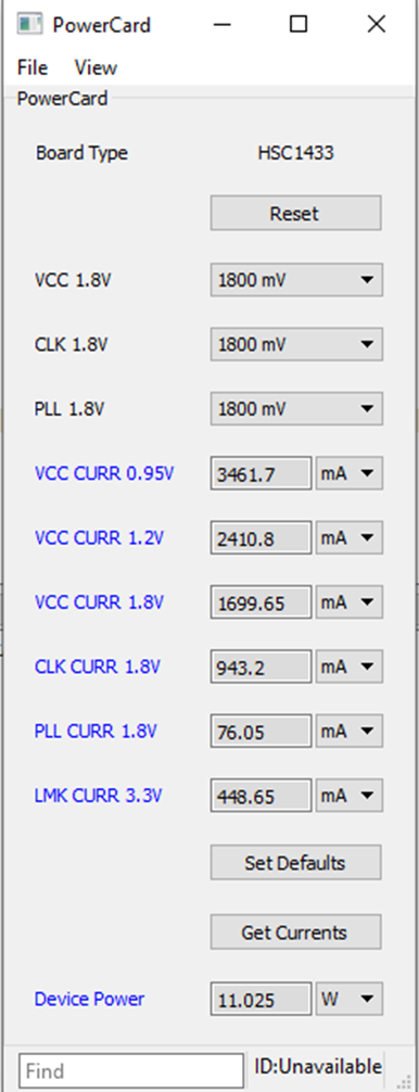

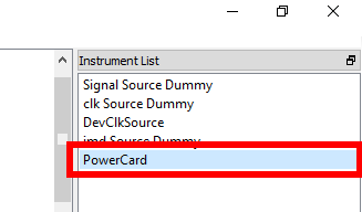

    When using the AFE79xxEVM and Latte software you can use the 'PowerCard' to monitor the current on each of the rails. You can open the 'PowerCard' by double-clicking 'PowerCard’ in the Instrument List, picture is shown below.
    With the PowerCard open you can press the ‘Get Currents’ button to receive the current measurement for each rail.

  • Hi Franziskus,
    I had reached out through email last week to propose the idea that if the customer has a mode in mind, we could take some data on the EVM using the power card to see the power consumption of the device and the current per rail. Because there is likely not additional data aside from the different modes highlighted in section "7.9 Power Supply Electrical Characteristics" of the datasheet.
    If that would help, could you please provide us with the customers desired mode? We believe this to be more effective as the measurements will be in the customers desired mode.
    Camilo
