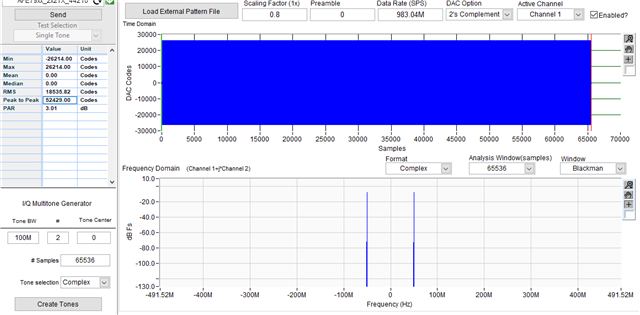

I would like to generate two-tones for IP3 test, 3544MHz and 3556MHz from a DAC output. Can you please explain how to set this up at the Latte? Also for two tones, I would like to set output power such as 10dB backoff for wach tone from the Fullscale. If you have an example code that I can apply, please let me know.

    The way of doing this depends on which FPGA board you are using with the AFE7950. Are you using a TSW14J56, TSW14J57 or a TSW14J58? Or a different FPGA?
    For the TSW14J56 or TSW14J57 in HSDCpro, in the I/Q Multitone Generator, you can select the number of tones, their bandwidth and their center.
    And for the amplitude there is a scaling factor, for -10dBFS the scaling factor = 10^(-10dBFS/20) = 0.3162278.

  • Hi Camilo,
    I am using ZCU102 with Latte software. Can you please send a sample script for two tone generation with DAC DSA setting script together for per tone otuput control?
