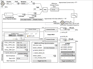

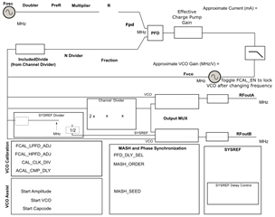

  • Luca, it sounds to me like the issue is that none of the configuration boxes are showing up anywhere in the GUI, preventing you from entering register settings and PLL configuration, similar to the images below.
    Expected:
    Instead seeing:
    Is this correct?
    This is a bug in 1.7.7.1 with parsing the text value of the controls on the GUI, and is fixed in 1.7.7.2 (newly available on the web as of last week).
