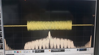

Could you check below weird spectrum?
Customer would like to use 1.5GHz interface rate on 1 Tx ch.
Center frequency is now 5GHz due to spectrum analyzer specification but they will use 9.6GHz finally.

  • Hi David,
    Some questions to help debug:
    • Is this configuration for a custom board?
    • What are you sending to the DAC? Is it supposed to be a CW tone?
    • Could you specify what is the frequency per division on the horizontal axis of your picture?
    • I see there is some changed lane Mux settings on the DAC side, did you also account for any lane inversions?
    • What JESD errors are you getting on the DAC side?
    Camilo
  • Hi Camilo,
    Is this configuration for a custom board? -> yes.
    What are you sending to the DAC? -> Linear FM.
    Is it supposed to be a CW tone? -> I will try to.
    Could you specify what is the frequency per division on the horizontal axis of your picture? -> It is 2GHz span.
    I see there is some changed lane mux settings on the DAC side, did you also account for any lane inversions? -> If you like to change other lanes, I need change other IO bank.
    What JESD error are you getting on the DAC side? -> No, I don't know how to get the information.
  • Hi Camilo,
    I made a single tone pulse signal.
    When I transmit the single tone pulse, The spectrum looks like below image.
    Thank you Camilo
  • Hi Byungsoo,
    I was able to set this up in our bench and see a good DAC output. Then I inverted one of the lanes (Meaning swapping p and n of a differential pair) and was able to see an output similar to yours to recreate the issue.
    This leads us to believe that the issue is that one of your SerDes lanes is inverted in polarity. Could you please double check that the polarity has been accounted for and put a 1 in the parameters below for the lanes that are inverted in layout.
    sysParams.serdesTxLanePolarity =[0,0,0,0,0,0,0,0]#ADC STX1 - 8 Polarity
    sysParams.serdesRxLanePolarity=[0,0,0,0,0,0,0,0]#DAC SRX1 - 8 Polarity
    If fixing the polarity did not fix the DAC output and you are programming the AFE by converting the python file into a log with the SPI transactions, there should be a section towards the end of the file that read checks registers inside the DAC_JESD_AB and DAC_JESD_CD pages to check for the errors.

  • Hi Camilo,
    I checked my board schematic. I did not connect opposite way. Even I connected the lanes. I set the polarity [False,True,True,False,False,False,False,False].
    In that case, I can not see any pulse.
    I need change some function to answer you like to know.
    Thank you.
  • Hi Byungsoo,
    Just to verify, did you also try once with sysParams.serdesRxLanePolarity=[0,1,0,0,0,0,0,0] and another time with sysParams.serdesRxLanePolarity=[0,0,1,0,0,0,0,0] ?

    When the sysParams.serdesRxLanePolarity=[0,1,0,0,0,0,0,0] is set, I can see the signal output.
    When the other setting is sysParams.serdesRxLanePolarity=[0,0,1,0,0,0,0,0], I can see the signal output.

    During I read back the value for each address, The RF Output is follow as
    And I try to read many times the address, I can not see other values.

    I found the problem. It is came from me. I missed the connection to top module for looking the comma align lock(0x00EE) and cs state(0x00A2), bus state (0x00A6).
    After fixed the problem, I can see 0xFF for the comma align lock (0x00EE) and 0xAA for the cs state (0x00A2), 0xFF for the bus state (0x00A6).
    And I fixed the spectrum problem. It is cause the RBD.
