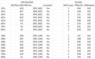

The problem I was thinking of was as follows:
1. Lanes are incorrectly connected in AFE7950EVM and ZCU102.
2. ZCU102 sends an incorrect value to the lane.
I am wondering which PIN of HPC1 of ZCU102 should the lanes of AFE7950EVM be connected to to check for this problem.

  • Hi Jeongju,
    For HPC1 of the ZCU102 the AFE is connected to the following pins:
    The LOS error is indicating that one of the lanes on the AFE is not receiving data, which is usually an issue with choosing the incorrect lanes on either the AFE or FPGA side.
    David Chaparro
