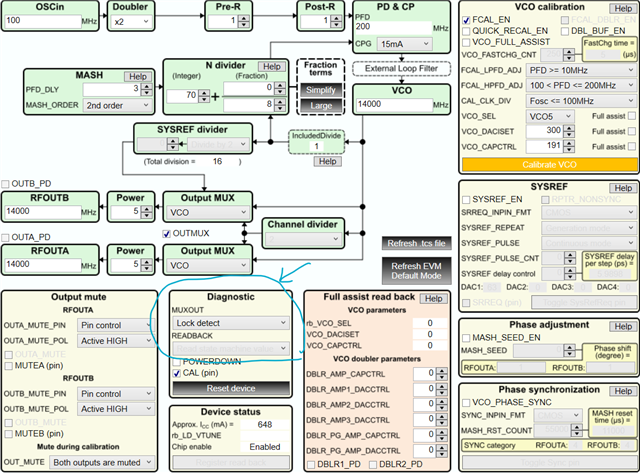

    I used TICS Pro default configuration and then plugged in your initialization setting, I got this.
    1. OUTMUX=0, so Output MUX is pin control. That is, whether the output is direct VCO, divide down or VCO doubler output is controlled thru pin strapping. If this is not your intention, set OUTMUX = 1.
    2. Are you going to mute output B?
    3. If you do not need VCO doubler, FCAL_DBLR_LE should be =0.
    4. CAL_CLK_DIV setting does not match with the reference clock frequency. This is not a big deal since you will use full assist.
    5. Only these 3 registers will be double buffered. Other related registers such as PLL_NUM and VCO doubler parameters will not be double buffered.
    Your initialization programs only a few registers, please program all the registers, from R79 to R0 because the application settings may not be identical to the silicon reset setting.
    I suggest use the follow configuration for LUT creation.
    1, READBACK should be =1 to read back the calibrated data.
    2. if VCO doubler is needed, set FCAL_DBLR_EN = 1
    3. read back these data

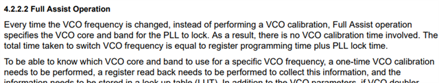

    To use the LUT, first of all, initialize the device with the following configuration.
    This is again a no-assist calibration with MUXOUT set as lock detect output. The reason using no-assist calibration for initialization is to ensure the lock detector will response in full assist mode.
    After initialization, now enable full assist mode.
    1. make change to these bits. Set FCAL_EN and FCAL_DBLR_EN = 0 first.
    2. use the data from LUT to program these registers
    3. Program R0 to make the change effective.
