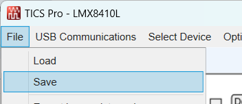

  • Hi Carlos,
    Since you use TICS Pro, please send me the .tcs configuration file, thanks.
  • ForTexasForum.tcs
    Hi Noel,
    Here is the .tcs file. Thank you very much.

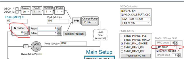

  • Hi Carlos,
    Unfortunately, I still don't understand your problem.
    Is the PLL unable to lock? Are you not able to change the frequency? Or something else?

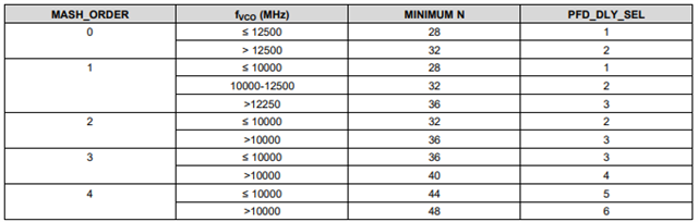

    Your configuration has an issue. There is restriction on the PLL_N value which is dependent on the MASH order.
    The restriction is like this.
    So for PLL_N=40, change the MASH order to 3rd order and change the PFD delay accordingly to 3.

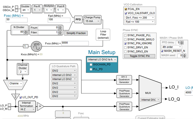

  • Hi Noel,
    We are working with a custom board that uses the LMX8410 as a demodulator, controlled via SPI by a PIC microcontroller. The configuration we attach from TICs Pro is the initialization we currently apply to the demodulator. After this initialization, we don’t change any other settings.
    Our initialization sequence is as follows:
    1. Enable the demodulator.
    2. Write to registers 127 and 6 as recommended in the datasheet.
    3. Trigger a reset through Register 0.
    4. Write all registers in descending order.
    5. Wait 10 ms, check the VCO lock status, and then enable DCOC calibration.
    The temperature issue we had before is already solved, but now we are facing two main problems:
    We check the VCO lock status through the MUXout pin. It indicates that there is lock after initialization, but if we disable the enable pin (set it to 0 V), the MUXout pin still shows a lock condition.
    We are not observing the expected IF output corresponding to LO – RF. We suspect this could be related to incorrect configuration of mash order and delay (DLY) with respect to our VCO and PFD settings.
    Our setup: PFD = 100 MHz, 50 MHz at OSCin with the doubler enabled.
    • We target 6.5 GHz at the LO, so we aim for 13,000 MHz at the VCO with CHDIV2 enabled.
    • Could you please help us with the following points?
    • Why does the MUXout pin (VCO cal) remain HIGH even after the enable pin is de-asserted?
    • Can you confirm whether our configuration is correct for achieving the LO output through CHDIV2, and if the rest of the setup looks valid?
    The table information about N and MASH Order restrictions is clear, however, the file I sent you was using a 8000 Fvco Frequency, with N = 40, and MASH = 4th, DLY = 5. According to this table, this values should be correct. What would be the configuration for the values we are aiming? With N between 80 and 150.
    I hope this clarifies our issue. If anything is not clear, I will be glad to provide further details.
    Thanks a lot,
  • Hi Carlos,
    After initialization and PLL lock, when you set CE pin = 0, did you see a significant current drop?
    The min. N is 44 with 4th order MASH.
    Let me check if I have a board in the lab I can try.

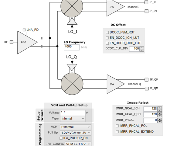

    We so sorry, there was a confusion writing our previous answer. Effectively, we are writing to R0 bit 0. Our configuration is 0x0004 and when we activate it is 0x0005, and however, as we told you before, the problem with the Lock Status is still there.
    Could you please check if the configuration we are using with the rest of registers is ok or do you find something else wrong? Our tests include introducing a signal into the RF IN pin, and measuring the output pins (QP, QM, PQ, PM). Our LO configuration says we are at 6.5GHz, but the tests say we are around 8GHz and we cannot find why. Here's a table with some results we've obtained if it's useful:
    RF IN IF OUT
    6.9 GHz 1.088 GHz
    6.8 GHz 1.189 GHz
    6.7GHz 1.289 GHz
    7 GHz 970 MHz
