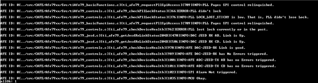

AFE7950EVM: Issues in dynamic parameter configuration of AFE using CAFE Library
Part Number: AFE7950EVM
I want to dynamically configure the parameters of the AFE using the CAFE library. To achieve this, I followed the document "Implementing the CAFE Library in Vitis."
I copied the CAFE library's header files into the include folder of my project, and the source files into the Src folder. I then updated the read, write, log, and delay functions accordingly.
Next, I used the AFE.saveCAfeParamsFile() function in the AFE79xx software to save the afe79xxParameters, and replaced the contents of the init_tiAfe79DeviceInfo_t structure with the newly generated file, as shown below:

Then called the checkdevicehealth() function like this,
uint16_t allOk = 0;
AFE79FNP (checkDeviceHealth) (&tiAfe79DeviceInfo_t, &allOk); //This function Reads the complete device health and returns it as a pointer.
xil_printf("allOk: %d\r\n", allOk);
Its output is;

  • Hi Nourmeer,
    Just to confirm, before running the check device health have you configured the AFE using a generated log file from Latte? If you clear the errors and read again do you continue to see the PLL lost lock in the past error?
    Please note that a log or hex file must be generated by Latte and this will be used to configure the AFE. It is not possible to modify the AFE configuration by modifying systemParams structure. To confirm that the system params structure has been update
    In regard to your other issues, have you confirmed that the systemParams are correct in the structure?
    Can you try using the following format for the contents of the 'tiAfe79_afeParameters' file (Only replace line 4 with your contents)?
    void init_tiAfe79DeviceInfo_t(AFE79_INST_TYPE afeInst)
    	//Place the systemParams structure from the file generated by the AFE.saveCAfeParamsFile fucntion here.
    	afeInst->afeSystemParams =systemParams;
    David Chaparro
