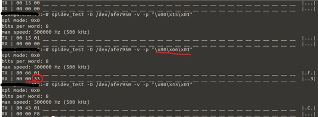

AFE7950: Lane Link Issues
Part Number: AFE7950
We are having considerable difficulty getting the lanes to link properly with the AFE7950 in a custom design. We are clocking the AFE7950 with LMK04828B. Our JESD lanes go to a Zynq SoC.
From the CAFE API, we receive conflicting indications that the the PLL in the AFE7950 is locked.
Additionally, some of lanes make it partially through the link sequence, passing clock sync (CS) but failing frame sync (FS).
afe79xx_control --health
AFE ID: 0[tiAfe79_basicFunctions.c][ti_afe79_requestPllSpiAccess][709]INFO:PLL Pages SPI control relinquished.
AFE ID: 0[tiAfe79_controls.c][ti_afe79_checkPllLockStatus][366]ERROR:PLL didn't lock
AFE ID: 0[tiAfe79_controls.c][ti_afe79_checkPllLockStatus][376]INFO:PLL LOCK_LOST_STICKY is low. That is, PLL didn't lose Lock.
AFE ID: 0[tiAfe79_controls.c][ti_afe79_checkDeviceHealth][962]ERROR:PLL lost lock currently or in the past.
AFE ID: 0[tiAfe79_jesd.c][ti_afe79_getJesdRxLinkStatus204B][475]ERROR:DAC JESD RX AB. Link Not Up. Passed CS State but failed FS State. Probably still receiving K Chas
AFE ID: 0[tiAfe79_jesd.c][ti_afe79_getJesdRxLinkStatus204B][511]ERROR:DAC JESD RX CD. Link Not Up. Passed CS State but failed FS State. Probably still receiving K Chas
AFE ID: 0[tiAfe79_controls.c][ti_afe79_checkDeviceHealth][973]ERROR:AFE DAC-JESD-RX Link Down.
AFE ID: 0[tiAfe79_jesd.c][ti_afe79_getJesdRxLaneErrors][265]ERROR:JESD RX Lane Error for lane 0 seen: JESD 204B: 8b/10b disparty error. JESD 204C: sync_header_parity_r
AFE ID: 0[tiAfe79_jesd.c][ti_afe79_getJesdRxLaneErrors][265]ERROR:JESD RX Lane Error for lane 0 seen: JESD 204B: 8b/10b not-in-table code error. JESD 204C: sync_header
AFE ID: 0[tiAfe79_jesd.c][ti_afe79_getJesdRxLaneErrors][265]ERROR:JESD RX Lane Error for lane 0 seen: code synchronization error
AFE ID: 0[tiAfe79_jesd.c][ti_afe79_getJesdRxLaneErrors][265]ERROR:JESD RX Lane Error for lane 0 seen: elastic buffer match error. The first no-/K/ does not match 'mats
AFE ID: 0[tiAfe79_jesd.c][ti_afe79_getJesdRxLaneFifoErrors][310]ERROR:SerDes Rx Lane 0 got LOS error. There may be a SerDes Eye issue.
AFE ID: 0[tiAfe79_jesd.c][ti_afe79_getJesdRxLaneFifoErrors][315]ERROR:SerDes Rx Lane 0 got FIFO Error. There may be a SerDes Eye issue or FIFO offset issue.
AFE ID: 0[tiAfe79_jesd.c][ti_afe79_getJesdRxLaneErrors][265]ERROR:JESD RX Lane Error for lane 1 seen: JESD 204B: 8b/10b disparty error. JESD 204C: sync_header_parity_r
AFE ID: 0[tiAfe79_jesd.c][ti_afe79_getJesdRxLaneErrors][265]ERROR:JESD RX Lane Error for lane 1 seen: JESD 204B: 8b/10b not-in-table code error. JESD 204C: sync_header
AFE ID: 0[tiAfe79_jesd.c][ti_afe79_getJesdRxLaneErrors][265]ERROR:JESD RX Lane Error for lane 1 seen: code synchronization error
AFE ID: 0[tiAfe79_jesd.c][ti_afe79_getJesdRxLaneErrors][265]ERROR:JESD RX Lane Error for lane 1 seen: elastic buffer match error. The first no-/K/ does not match 'mats
AFE ID: 0[tiAfe79_jesd.c][ti_afe79_getJesdRxLaneFifoErrors][310]ERROR:SerDes Rx Lane 1 got LOS error. There may be a SerDes Eye issue.
AFE ID: 0[tiAfe79_jesd.c][ti_afe79_getJesdRxLaneFifoErrors][315]ERROR:SerDes Rx Lane 1 got FIFO Error. There may be a SerDes Eye issue or FIFO offset issue.
AFE ID: 0[tiAfe79_jesd.c][ti_afe79_getJesdRxLaneErrors][265]ERROR:JESD RX Lane Error for lane 4 seen: JESD 204B: 8b/10b disparty error. JESD 204C: sync_header_parity_r
AFE ID: 0[tiAfe79_jesd.c][ti_afe79_getJesdRxLaneErrors][265]ERROR:JESD RX Lane Error for lane 4 seen: JESD 204B: 8b/10b not-in-table code error. JESD 204C: sync_header
AFE ID: 0[tiAfe79_jesd.c][ti_afe79_getJesdRxLaneErrors][265]ERROR:JESD RX Lane Error for lane 4 seen: code synchronization error
AFE ID: 0[tiAfe79_jesd.c][ti_afe79_getJesdRxLaneErrors][265]ERROR:JESD RX Lane Error for lane 4 seen: elastic buffer match error. The first no-/K/ does not match 'mats
AFE ID: 0[tiAfe79_jesd.c][ti_afe79_getJesdRxLaneFifoErrors][310]ERROR:SerDes Rx Lane 4 got LOS error. There may be a SerDes Eye issue.
AFE ID: 0[tiAfe79_jesd.c][ti_afe79_getJesdRxLaneErrors][265]ERROR:JESD RX Lane Error for lane 5 seen: JESD 204B: 8b/10b disparty error. JESD 204C: sync_header_parity_r
AFE ID: 0[tiAfe79_jesd.c][ti_afe79_getJesdRxLaneErrors][265]ERROR:JESD RX Lane Error for lane 5 seen: JESD 204B: 8b/10b not-in-table code error. JESD 204C: sync_header
AFE ID: 0[tiAfe79_jesd.c][ti_afe79_getJesdRxLaneErrors][265]ERROR:JESD RX Lane Error for lane 5 seen: code synchronization error
AFE ID: 0[tiAfe79_jesd.c][ti_afe79_getJesdRxLaneErrors][265]ERROR:JESD RX Lane Error for lane 5 seen: elastic buffer match error. The first no-/K/ does not match 'mats
AFE ID: 0[tiAfe79_controls.c][ti_afe79_checkDeviceHealth][984]ERROR:AFE DAC-JESD-RX has some errors triggered.
AFE ID: 0[tiAfe79_controls.c][ti_afe79_checkDeviceHealth][1001]INFO:AFE ADC-JESD-TX AB has no Errors triggered.
AFE ID: 0[tiAfe79_jesd.c][ti_afe79_getJesdTxFifoErrors][914]ERROR:JESD TX Lane Serdes FIFO Error for lane 0. SerDes PLL isn't locked or the FIFO offset setting is inc.
AFE ID: 0[tiAfe79_jesd.c][ti_afe79_getJesdTxFifoErrors][914]ERROR:JESD TX Lane Serdes FIFO Error for lane 1. SerDes PLL isn't locked or the FIFO offset setting is inc.
AFE ID: 0[tiAfe79_jesd.c][ti_afe79_getJesdTxFifoErrors][914]ERROR:JESD TX Lane Serdes FIFO Error for lane 2. SerDes PLL isn't locked or the FIFO offset setting is inc.
AFE ID: 0[tiAfe79_jesd.c][ti_afe79_getJesdTxFifoErrors][914]ERROR:JESD TX Lane Serdes FIFO Error for lane 3. SerDes PLL isn't locked or the FIFO offset setting is inc.
AFE ID: 0[tiAfe79_controls.c][ti_afe79_checkDeviceHealth][1006]ERROR:AFE ADC-JESD-TX CD has some errors triggered.
AFE ID: 0[tiAfe79_controls.c][ti_afe79_checkDeviceHealth][1023]INFO:SPI Alarm Not triggered.
AFE ID: 0[tiAfe79_controls.c][ti_afe79_checkDeviceHealth][1035]INFO:MCU Okay.
AFE Device Health 0x7
Any guidance on the root cause of these issues is appreciated. If there are additionaly diagnositics that would be insightful, please let us know. We have also attached our configuration file for the device.

  • Hi Sam,
    Was this configuration tested with the AFE EVM and TSW board before moving to the custom board? Have you probed the clocks and verified they are the correct frequency and are stable (are the lmk plls locked)?
