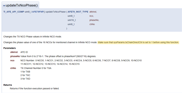

Basically, after init, we use the CAFE function updateTxNco for each of the Tx channels to set transmission frequency. This is what we do also when stop/starting transmission (we set again the same frequency).
I have the impression that the NCOs of the Tx channels do not have the same phase as they are not started simultaneously.
What shall we do to always have the same phase difference in Tx ?

  • Hi Florian,
    Please try using the C API function, updateTxNcoPhase(). You can manually set the phase for all TX channels. Please let me know if this method provides expected results on your set up.
    Note that "sysParams.txChainDirectCtrl" should be set to 1 before using this function.

    Regarding the suggested functions, I have a few questions about what it does and how it works.
    What is exactly the phase that is being set, since a signal phase changes continuously ?
    Is it set the moment the instruction is sent ?
    I need to have all 4 NCOs used for my 4 channels with the same phase, that is understood.
    But since I can not set the phase for all 4 NCOs with a single instruction, will this do the job ?
    If I set phase of NCO channel 1 to 0, then channel 2, then 3, then 4, will they be synchronous and have the same phase ?
    Also the effect of sysParams.txChainDirectCtrl = 1 is quite mysterious to me. What is it doing ? I did not find any information about it.
    It seems to be used during system initialization with Latte, so on our side, it will impact the generated SPI binary used for initialization.
    Today, it seems that this parameter is set to 0 in our script since it is the default value, so we will need to change it and redump the SPI configuration.

  • Hi Florian,
    1. This is a numerically controlled oscillator (NCO), so we can add phase delta to the NCOs digitally. The best way to observe the phase delta is by using a single tone waveform.
    2. Yes, you can set the phase one NCO at a time, and they should be aligned.
    3. The sysParams.txChainDirectCtrl function decides how the mixers in the TX digital path are configured. Because the TX path supports two mixers, front and back, there are certain functions/features that only work when using the back mixer. By setting sysParams.txChainDirectCtr equal to 1, the TX digital path is being configured to use only the back mixer. This allows us to update the NCO phase and use all configurable NCO values.

    Hello Mirana, here is our script. By changing the Tx DAC frequency to 8 847,36MHz, the configuration is accepted. But we are not sure about the use of FCW.
  • And could you also advice which function shall we use to update Tx frequency ?
    updateTxNcoMultiNcoMode() or updateTxNco() ?
    For the moment, we use updateTxNco(), but it does not seem to work (on the bench the Tx spectrum on the spectrum analyzer has 2 peaks at frequencies that do not correspond to the set one). We have noticed that in Latte script, function updateTxNcoMultiNcoMode() is used.
    We use latte 2p8 and CAFE 2p6.
    Thanks.
  • Hi Florian,
    The updateTxNcoPhase() function only works for Fdac rates equal to or less than 9G. For a 9G Fdac rate, the DAC also cannot be in IL mode.
    Because you're using a single band configuration, the updateTxNco() function should be sufficient. However, I'm seeing similar behavior on my setup after using the updateTxNco() function. It looks like the updateTxNco() function works as expected when the txDirectChainCtrl parameter is set to 0. I am working to test the register writes to update the NCO phase, without that parameter. I will update you as soon as I am able; I appreciate your patience!
    Thanks!
    Mirana
  • Hello Mirana,
    thanks for taking time to help us.
    Actually, the phase stability is achieved by setting  txDirectChainCtrl=1, so we do not need to use updateTxNcoPhase().
    We have set Fdac =  8 847,36MHz and use updateTxNcoMultiNcoMode() and updateRxNcoMultiNcoMode() to change frequency, and the phase difference is now constant between start/stop and system reboots. We have also tested the TDD override with success.
    With this setup, we have achieved what we needed regarding phase stability.
    The remaining issue on our side is to change Nyquist zone dynamically as described here :  AFE7920EVM: How to use the opcodes to update system after initial configuration
    Florian.
