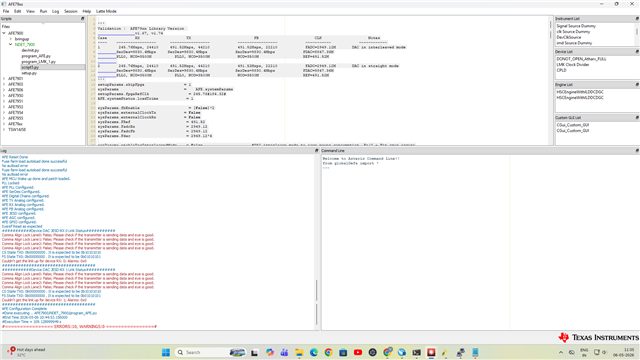

  1. I have pasted LMKProgram.py program. My issue will be written in next point.(Note:  LMK is getting programmed and I am getting qpll acknowledgement)
  2. I am trying to program Afe but i am getting follwoing errors (AFE is not getting programmed)
    #Executing .. AFE7900/NDET_7900/program_AFE.py
    #Start Time 2026-05-06 10:43:04.027000
    The External Sysref Frequency should be an integer factor of: 3.84MHz
    2T2R1F Number: 0
    Valid Configuration: True
    laneRateRx: 9830.4
    laneRateFb: 9830.4
    laneRateTx: 9830.4
    2T2R1F Number: 1
    laneRateRx: 9830.4
    laneRateFb: 9830.4
    laneRateTx: 9830.4
    LMK and FPGA Configured.
    DONOT_OPEN_Atharv_FULL - Device registers reset.
    chipType: 0xa
    chipId: 0x78
    chipVersion: 0x11
    AFE Reset Done
    Fuse farm load autoload done successful
    No autload error
    No autload error
    AFE MCU Wake up done and patch loaded.
    PLL Locked
    AFE PLL Configured.
    AFE SerDes Configured.
    AFE Digital Chains configured.
    AFE TX Analog configured.
    AFE RX Analog configured.
    AFE FB Analog configured.
    AFE JESD configured.
    AFE AGC configured.
    AFE GPIO configured.
    Sysref Read as expected
    ###########Device DAC JESD-RX 0 Link Status###########
    Comma Align Lock Lane0: False; Please check if the transmitter is sending data and eye is good.
    Comma Align Lock Lane1: False; Please check if the transmitter is sending data and eye is good.
    Comma Align Lock Lane2: False; Please check if the transmitter is sending data and eye is good.
    Comma Align Lock Lane3: False; Please check if the transmitter is sending data and eye is good.
    CS State TX0: 0b00000000 . It is expected to be 0b10101010
    FS State TX0: 0b00000000 . It is expected to be 0b01010101
    Couldn't get the link up for device RX: 0; Alarms: 0x0
    ###########Device DAC JESD-RX 1 Link Status###########
    Couldn't get the link up for device RX: 1; Alarms: 0x0
    AFE Configuration Complete
    #Done executing .. AFE7900/NDET_7900/program_AFE.py
    #End Time 2026-05-06 10:44:53.156000
    #Execution Time = 109.128999949 s
    #================ ERRORS:10, WARNINGS:0 ================#

    # sysParams.agcParams[0].fltPtMode = 0 ##if exponent > 0, dont send MSB
    # sysParams.agcParams[0].fltPtFmt = 1 ##3 bit exponent
    ## The following parameters sets up the GPIOs
    sysParams.gpioMapping={
            'H8': 'ADC_SYNC0',
            'H7': 'DAC_SYNC0',
            'N8': 'ADC_SYNC2',
            'N7': 'ADC_SYNC3',
            'H9': 'ADC_SYNC1',
            'G9': 'DAC_SYNC1',
            'N9': 'DAC_SYNC2',
            'P9': 'DAC_SYNC3',
            'P14': 'GLOBAL_PDN',
            'K14': 'FBABTDD',
            'R6': 'FBCDTDD',
            'H15': ['TXATDD','TXBTDD'],
            'V5': ['TXCTDD','TXDTDD'],
            'E7': ['RXATDD','RXBTDD'],
            'R15': ['RXCTDD','RXDTDD']}
    #AFE.systemParams.papParams[0]['enable'] = True
    #AFE.systemParams.papParams[1]['enable'] = True
    #AFE.systemParams.papParams[2]['enable'] = True
    #AFE.systemParams.papParams[3]['enable'] = True
    setupParams.skipLmk    =    False
    AFE.initializeConfig()
    lmkParams.sysrefFreq = AFE.systemStatus.sysrefFreq
    lmkParams.lmkPulseSysrefMode = False
    AFE.LMK.lmkConfig()
