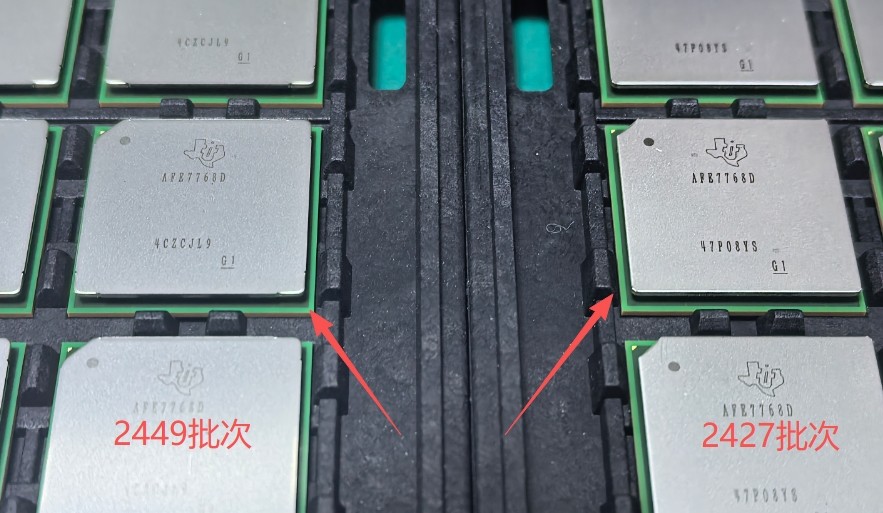

The supplied materials this time consist of two different production batches: DC2427 (90 pcs) and DC2449 (90 pcs)
Upon comparing the appearance of incoming materials from two batches, significant differences were observed in the chamfering edges of the device plastic cover plates (as shown in the figure below). The DC2449 batch features rounded chamfers, whereas the DC2427 batch has beveled chamfers.

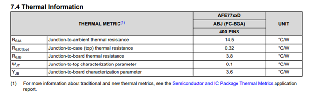

    From applications perspective, the edge of the metal lid should not impact the AFE7768D silicon performance nor the thermal performance. However, please allow me to double check with the internal team to confirm and get back to you.
    -Kang
  • Hello Anson
    I have confirmed internally:
    The metal lid on top of the AFE7768D device is for power dissipation. The shape of the metal lid will not impact the thermal performance. The customer will see the same thermal ratings (in the datasheet). Moreover, the metal lid will not impact the AFE7768D silicon performance as well.
