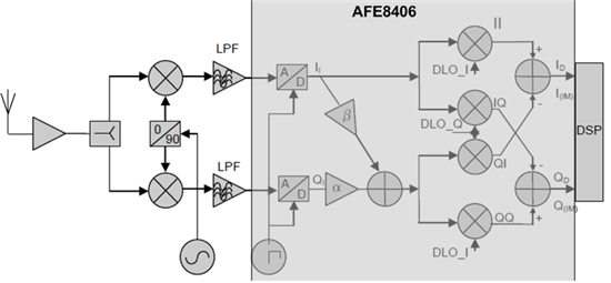

Hello! I would use chip AE8406 as a multi-carrier receiver  "digital low IF Weaver architecture" (see illustration). That is planned to use the chip in the "UMTS complex".
Questions:
- Do I understand, that AFE8406 DDC mixer - complex mixer (as I have quoted above figure)
- Is it possible to somehow compensate for the imbalance within the chip amplitude and phase I and Q quadrature I emerged after the analog mixer (with gains α and β to modify the I and Q signals)? Is it possible for this purpose to use the internal RAGC (though given that the external control amplifier connected to the AFE8406 with DVGA not in sight).
- is it possible to use RAGC Fixed gain of each of the quadrature

    The AFE8406 does not have an IQ correction block internal to the Figure 6-1, Figure 7-1 circuitry to provide for phase correction.  A set of custom software (not supported with the standard GC Studio AFE8406 software) could provide separate I and Q gain compensation only, but it is not an adder as shown in your diagram.
    The TRF 371x product which is a complex demodulator, has some IQ compensation and gain balance, and the two demodulated I and Q streams could be input to the AFE8406.  There is no direct EVM to demonstrate this, I think you would have to use the AFE8406EVM and a TRF3711 EVM together.
    There is an FPGA and TRF371x  EVM that provides for IQ correction and gain matching, please contact Ken Chan for futher information (kenchan@ti.com).
