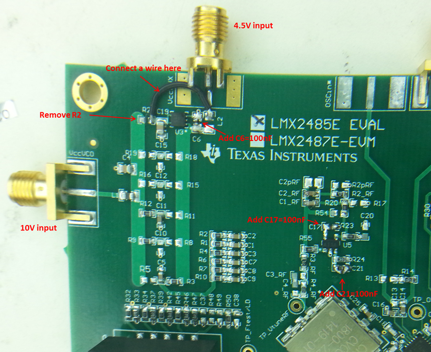

    The eval board has this VCO part
    Crystem CVCO55BE-1800-2200
    www.crystek.com/.../CVCO55BE-1800-2200.pdf

    I wish to know if the supply voltage is 10V for this eval board.
    The VCO output is now -20dBm and not able to lock.

  • Hi Ikon,
    You can do some modification to the EVM as below:
    To operate the board:
    Apply 10V to the SMA connector named VccVCO. This is the power supply to the VCO and the op-amp.
    Apply 4.5V to the SMA connector named VccAUX. This voltage will be regulated down to 3V for the rest of the circuitry.
  • Hi Noel,
    I had applied the re-work detail mentioned below.
    On the code loader, I enabled the bits as given in the manual.
    10V input to the VccVCO, 4.5V to the VccAux, 50MHz clock 4dBm level was fed in to Oscin,  RFout connected to spectrum.
    I was trying to use PLLatinum sim to get the loop filter value. Attached is the file from SIM.
    C1_RF, C2_RF, C3_RF, C4_RF all DNA,
    R2_RF, R3_RF, R4_RF are mounted with some discrete value.
    I presume to change these parts following the value in PLLatinum SIM tool?
