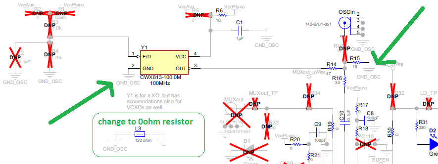

    Do the following when using external reference clock.
    1. Change L3 to 0ohm resistor (L3 is located next to OSCin SMA connector)
    2. Short GND_OSC to GND
    Furthermore, use the 10MHz out at the rear panel of spectrum analyzer instead of RF out from the signal generator, its quality is bad at low frequency.

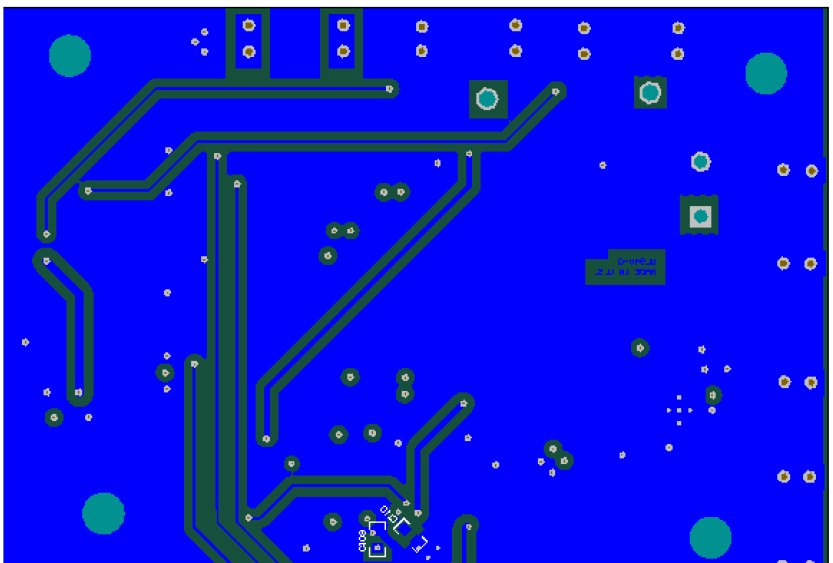

    Original layout (bottom side):

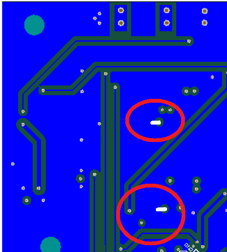

    Short GND together:

    When they tested using external Ref clock(10MHz), R15 moved to R13 and R6 removed.
    And they used 10MHz from rear pannel of signal generator.
    I think it is same the qualilty of 10MHz between Signal Generator and Spectrum Analyzer of rear pannel.
    As you mentiond,
    ==> L3, is this right Ref No.?
    ==> If they changed L3 to 0 ohm, it connected to GND already.
    Anyway, I will let them know this information(GND_OSC connect to GND), and ask the test result again.

  • Hi Alber,
    The on-board XO power supply should be disconnected, so remove R6. R14 shall also be removed to disconnect XO output.
    R13 and R16 should be change to 0 ohm, while R15 should be changed to 50 ohms.
    L3 is the ferrite bead connecting GND_OSC and GND. in the pcb layout, GND_OSC and GND are separated. Simply shorting these ground together by L3 is not enough, that's why I suggest shorting these ground together at multiple place.
