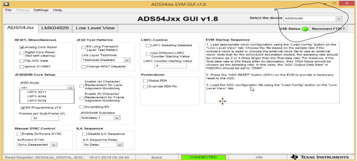

Hi Ebenezer,
1) Yes, we also require one lane per ADC.
2)After uploading the Mode 0 config file, it does not shows LMFS 4841 option in JESD mode drop down menu in GUI as shown in figure.

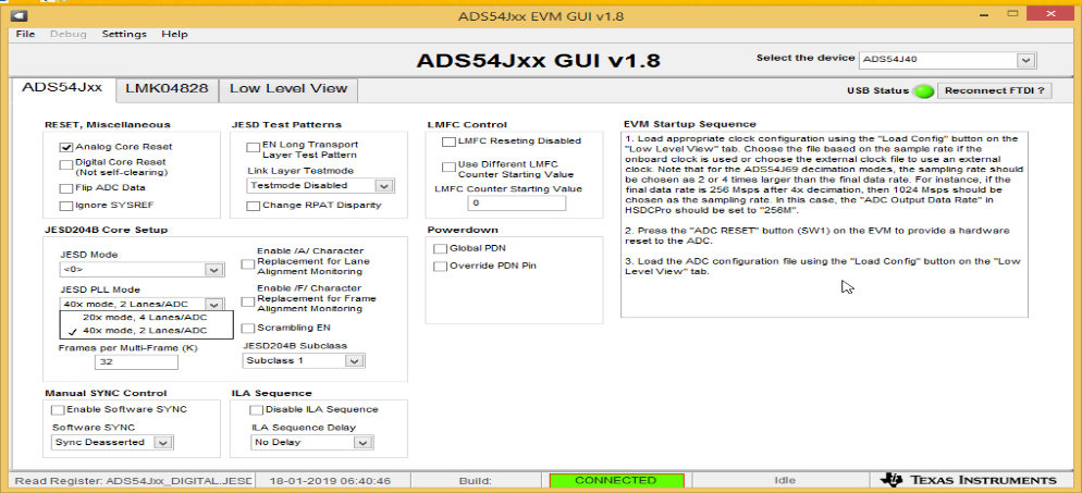

3)Also, we require 40x mode,4lane/ADC but this option is not present in JESD PLL Mode drop down menu in GUI as shown in figure.
4)Select the device Tab is showing Incorrect part number.

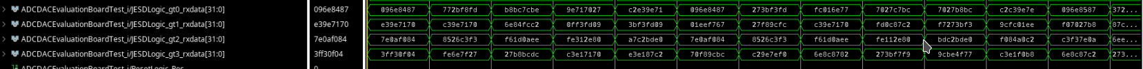

5) After uploading Mode 0 config file without making any changes, following is the output we are receiving. As it can be seen, we are not obtaining bcbc.. sequence in any of the four lanes. bcbc.. sequence is requird by FPGA to assert JESD SYNC signal.

The issue has been resolved.
Actually, the FPGA design has the issue and then modified the FPGA design which is working now.
There is no issue in ADC EVM.
