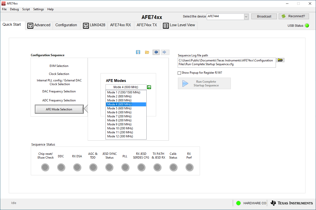

  • Hello Vijay,
    I reinstalled the software environment correctly, however my configuration of the card and more specifically of the LMK04828 does not work by using the AFE74xx software.
    This component is supposed to be configured after a SET MODE from the software, but it is not.
    I quote: “After you select the desired configuration mode, click Set Mode. Set Mode programs the onboard LMK04828 clocking chip. After set mode is complete, you should see the LED labeled LMK Lock on the AFE74xx-EVM go hot. This indicates that PLL loop two of the LMK chip is properly logged. ”
    Here are screenshots of my first configuration step in mode 6 and internal clock:
    As you can see, your software's recording window indicates that this SET MODE does not write or  read LMK04828 registers. The configuration of this component therefore doesn’t take place and I can’t continue configuring the card from the software.

    I have the same problem. Nothing happens after click in set Mode button in script windows.
    My questions are :
    -  What OS do you use on your computer?
    - Why don't I have some modes in gray? (see screenshot below)
    Thomas
    Vijay: The screenshot you attached is not viewable. I'm assuming you are referring to mode selection as in the below screenshot. The GUI doesn't grey out modes based on "DAC Frequency Selection" or "ADCC Frequency Selection". User has to manually select the right mode.
    Vijay
  • Hi Vijay,
    Thanks for your prompt response.
    First of all, sorry for the screenshot don't appear in my comment. The screenshot is exactly the one I wanted to put.

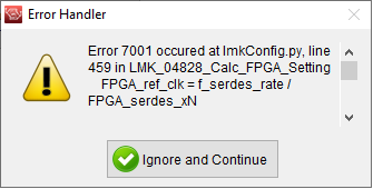

    To investigate the "set mode" problem, we put an oscilloscope on the SCK pin of the LMK (see screenshot below). We noticed no change in the SCK when pressing the "set mode" button.
    Moreover, an error is displayed in the GUI after using the "set mode" (see screenshot below).
    The full message is as follows:
    Error 7001 occured at lmkConfig.py, line 459 in LMK_04828_Calc_FPGA_Setting
        FPGA_ref_clk = f_serdes_rate / FPGA_serdes_xN
    UnboundLocalError:  local variable 'FPGA_serdes_xN' referenced before assignment
    Call Chain:
    -> lmkConfig.py, line 102 in LMK_Cnfg_Set_LMK04828
    -> GUI_Interface.py, line 185 in Wrapper_LMK_Cnfg
    Do you have any idea where this problem might come from?
    Thanks for your help.
    Thomas

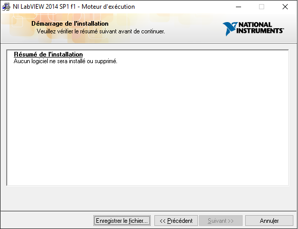

  • Hi Thomas,
    As you get an error when you click "set mode", this is a software issue. Looks like no SPI writes are going through. That's why you don't see any activity on SPI CLK.
    AFE74xxGUI uses labview runtime which is installed along with GUI. I suspect this might not have installed. Please uninstall GUI and reinstall it making sure that there is no error during installation.
    Also please open GUI as administrator and try to program EVM.
    Vijay
  • Hi Vijay,
    I verify and labview is installed along with GUI. I have installed and uninstalled several times, it still doesn't work. The screenshot below shows that the software has been installed correctly.

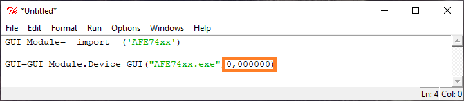

    I noticed another problem on the GUI in relation to the script window. I have a comma in the parameters and I saw in your previous screenshot that it was a dot. Wouldn't that be the problem? (see screenshot below)
    Thomas
