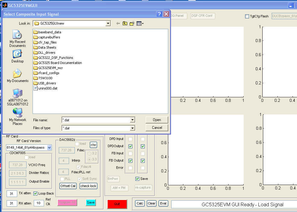

    To import a custom IQ input file:
       a) select the IQ rate of your input - update the Signal Setup Input Rate (Msps)
       b) prepare your input file - There is no need to create a Matlab file.  You can use a two column, white space delimited file, with 16bit signed integer values.  Typically you        would scale these to -1dbfs for 16 bits.
       c) Select Load Signal - On the popup menu, you can import other file formats by selecting "files of type" on the Select Composite Input Signal panel.  In the attached screen shot, I changed the files of type to .dat.  You can then browse for the desired input (composite set of carriers file).    Note: The input carrier file must be modulo 4 in length for the TSW3100 to properly wrap the 8-at-a-time memory update (this uses interleaved IQ, so the number of IQ elements must be modulo 4).
    The remainder of the processing is the same as other signals.

  • Hi Joe,
    Have you been able to successfully load IQ files (in the form of .dat or .txt) into the GC5325SEK GUI ? I tried loading a .dat file as suggested by you earlier. It comprises two columns ( one for I and another for Q). The error message that is returned states that "Subscript indices must either be real positive integers or logicals". What could the problem be ?
    We would like to know the format in which .mat files can be loaded onto the GC5325SEK so that IQ vectors available with us can be converted into .mat files that can be used with the GC5325SEK.
    Prem Krishnan
  • Prem,
    I've attached a small .mat file which will load into the GC5325.  This file is complex I+jQ column format in a .mat file.  You can also use 2 column txt file I Q as well.  The Matlab import window allows you to import various formats.  These 2 formats have been used without problems.
    Please see attached for a sample of the .mat format using I+jQ.  You can load this file into GC5325 GUI or into matlab.
    Ken.
