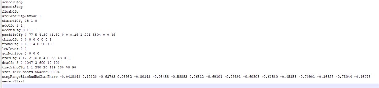

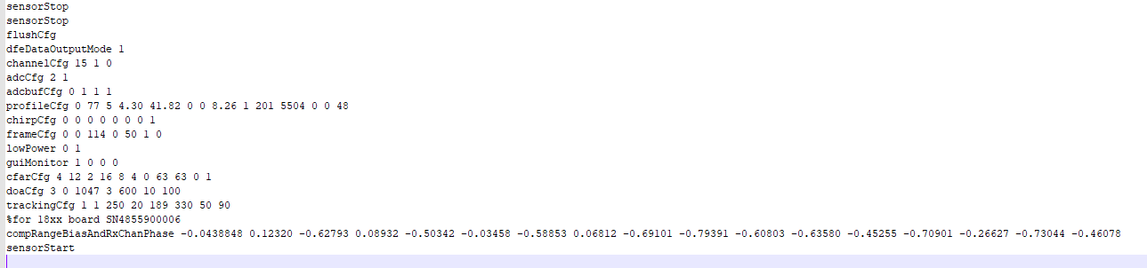

IWR1642 has very few reflection points.What causes this?

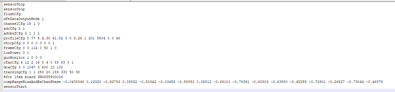

Here is my configuration,How do i change the configuration?I use it for vehicle identification ,Track and identify vehicles within 100 meters.
  • I use IWR1642 for vehicle detection and my routine is lab0013_traffic_monitoring_16xx.The configuration of the checkpoint is referenced by chirp_CONFIGs \ mmW_TM_demo_longrange.cfg and mmW_TM_demo_ph2.cfg.In the detection process, too few points are identified.And the distance is not far enough. I want a detection distance of about 100 meters.I need to change which configuration parameters in MMW_TM_demo_longrange.cfg.

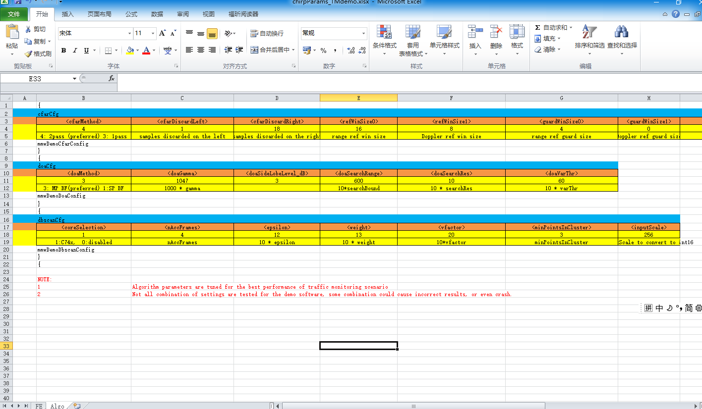

    According to your instructions, I have entered the directory mmwave_industrial_Toolbox_3_6_1 \ LABS \lab0013_traffic_monitoring_16xx\ GUI and have not found the two files parseCLICommands2Struct and calculateChirpParams,Only see chirpparams_tmdemo.xlsx in lab0013_traffic_monitoring_16xx\docs directory, as shown in the figure below:
    It is incomplete, for example, the doaCfg section has six parameters, but lab0013_traffic_monitoring_16xx\ chirp_CONFIGsmmW_TM_demo_longrange.cfg has seven parameters, as follows:
    doaCfg 3 0 1047 3 600 10 100,The parameter indicates that it is missing, and the parameter does not indicate the specific meaning or value range,
    Is there a specific document? Could you please provide me with a link or guide me to modify the parameters.
