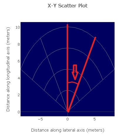

AWR1642BOOST: The angle of "X-Y Scatter Plot" of Demo Visualizer
Guru 16800 points
Part Number: AWR1642BOOST
Please let me know the angle drawn in the following figure.
The angle information is used to evaluate AWR1642BOOST.
I guess the angle is 27.5 degree.
Nomo
  • Hi Nomo-san,
    The angle of each arc is pi/6 radians or 30 degrees. You can view the source code for the visualizer by pressing F12 (or as mentioned in this thread) and look in the file app/mmWave.js. The X-Y scatter plot angles are set in the following code.

    You can also download the Visualizer source from https://dev.ti.com/gallery. Click the download button under mmWave_demo_Visualizer and download the zip file for your platform.
    -Nitin
  • Hello Nitin-san,
    Thank you for your reply.
    Your answer is helpful.
