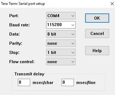

    You can use any terminal emulator program that allows you to access and write/read text to/from the COM ports on your computer. The mmWave SDK user guide mentions Tera Term as one option since it is a free, open-source terminal emulator program that you can download from the web. You should be able to find it by searching for "Tera Term" on Google. However, you can also use any other terminal program of your choice.
    Also, if you have any problems connecting to the EVM once you have Tera Term, please make sure to follow the instructions in the SDK user guide for selecting the correct COM port in Tera Term and also make sure the Tera Term Serial Port setup window has the Baud rate set to 115200.

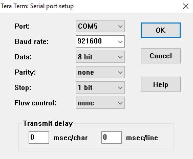

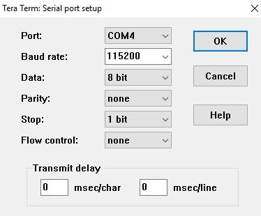

    3) Open 2 sessions of TeraTerm: one for Application/User port and one for Data Port (in my case COM4 and COM5, respectively).
    4) Set the ports as follows (No other settings have been made, is it right?):
    5) On the COM4 terminal, I sent exactly the same configuration commands reported in the configuration file "profile_2de.txt", i.e.

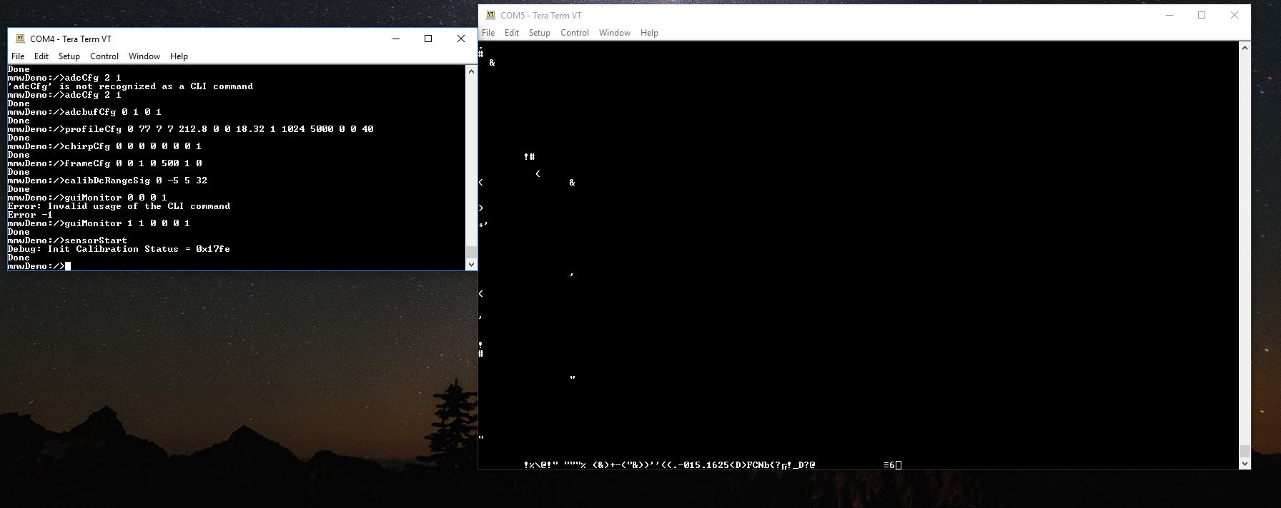

    6) After the last command, the COM5 terminal starts to "move", but the visualized symbols are not the same as discussed in the thread you suggested to read.
    Please, could you help me to understand where is the error?
    For sake of completeness, this is what I see after "SensorStart:
  • Davide,
    The flow you described is not from the step-by-step capture demo guide and cannot be used with the capture demo.  I am guessing that the flow you described came from the High Accuracy demo support thread (IWR1443BOOST: LEVEL SENSOR: Radar Studio e how-to have the value of level out of the board)?
    The instructions for the capture demo use only the Application/User COM port (but not the Data COM port) and involve loading the capture demo binaries (not High Accuracy demo binaries) using CCS.  If you have issues when following the instructions in the capture demo guide, please confirm which section/slide number in the guide that you are having trouble with and I can try to assist.
