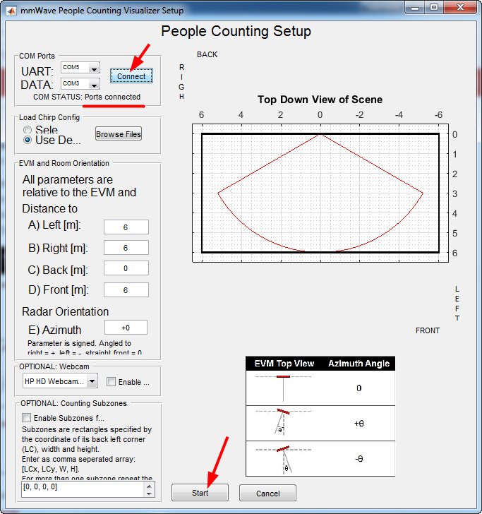

Attempt to run C:\ti\mmwave_industrial_toolbox_2_5_1__win\mmwave_industrial_toolbox_2_5_1\labs\lab0011-pplcount\lab0011_pplcount_quickstart\pplcount_gui.exe have failed (crashed).

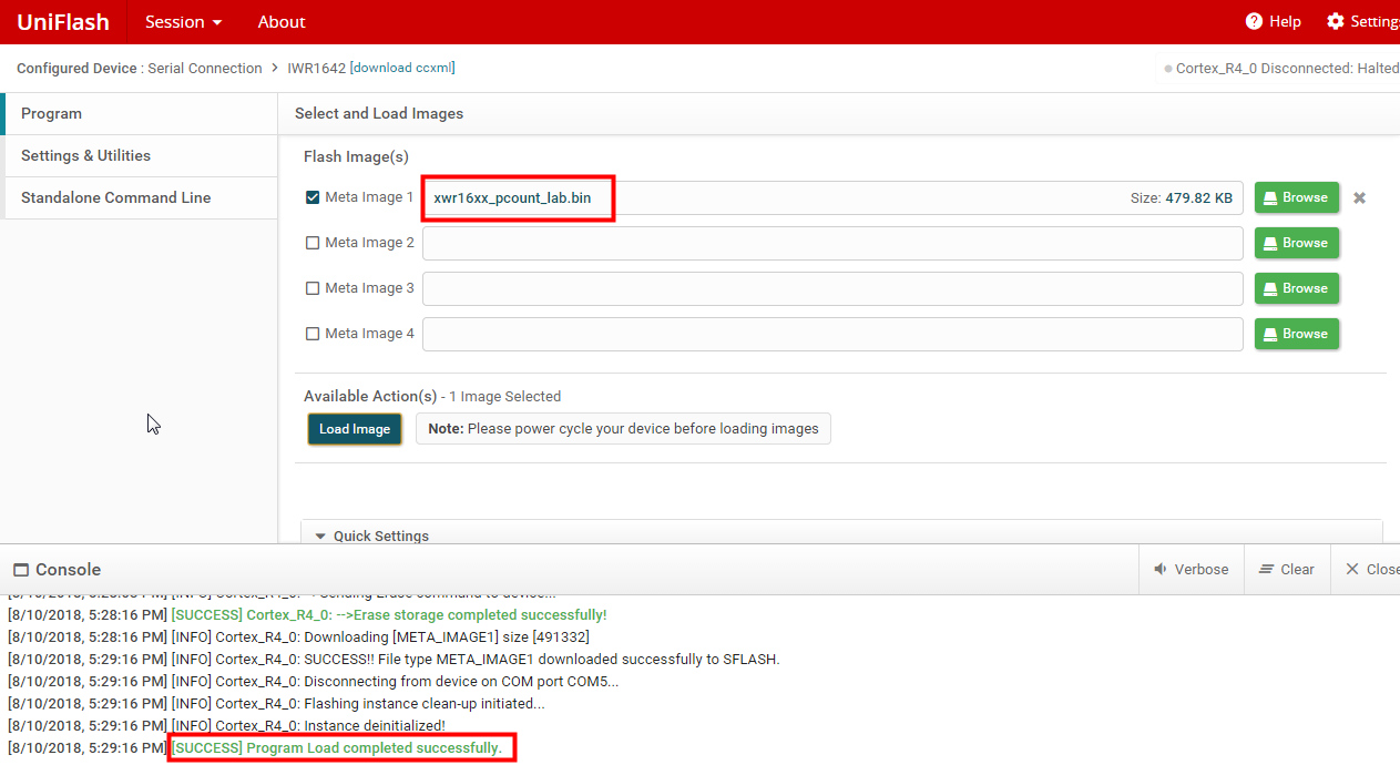

Successful Uniflash: xwr16_pcount_lab:
Visualizer is connected to EVM:

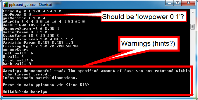

Demo error \ crash message:
What questions need to be asked to diagnose the root cause of the issue?    Looking forward to any good questions and diagnostics.

  • Hi Raymond,
    It looks like there is an error in the default configuration. The ES2 devices are required to run in low power mode, so the line lowPower 0 0 should be lowPowe 0 1.  You can find other configurations in <Industrial_Toolbox_2.5.1>/chirps/images/People+Counting+and+Tracking  with the correct lowPower call.
    If this does not fix the issue we can discuss a debug plan.
    Justin

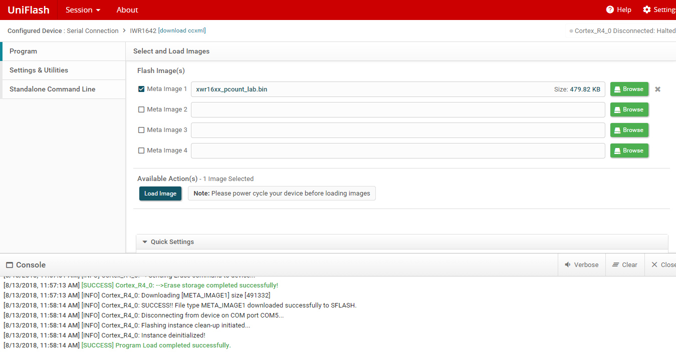

  • The .bin file was reflashed: C:\ti\mmwave_industrial_toolbox_2_5_1__win\mmwave_industrial_toolbox_2_5_1\labs\lab0011-pplcount\lab0011_pplcount_quickstart\xwr16xx_pcount_lab.bin

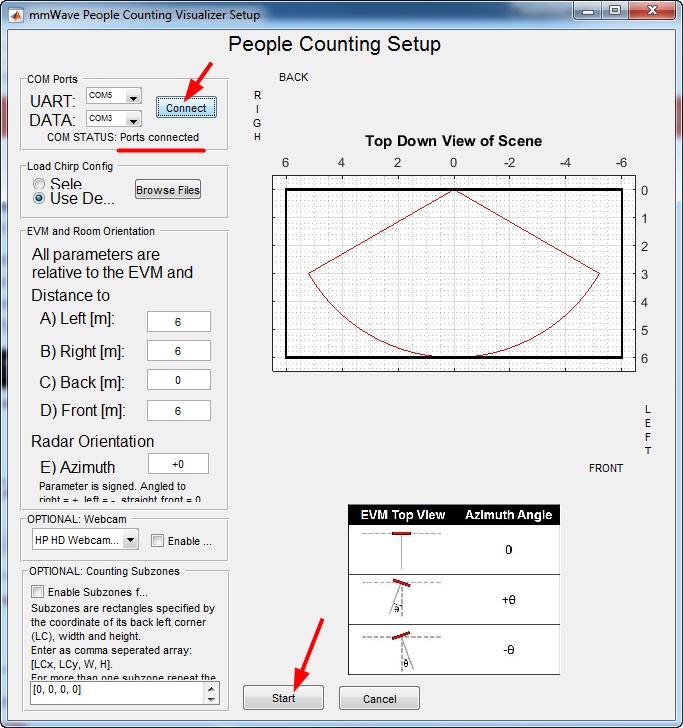

    A config file was selected from Visualizer UI:
    C:\ti\mmwave_industrial_toolbox_2_5_1__win\mmwave_industrial_toolbox_2_5_1\chirps\images\People+Tracking+and+Counting+Application\mmw_PC_6m_ConferenceRoom.cfg
    Feedback indicates the .cfg file was applied.:

    The error message indicates the application is crashing because of a timeout:: not receiving expected amount of data.  It would not surprise me that the index that exceeds the matrix dimensions, is the root cause of the problem.
    1)  Does it make sense to troubleshoot based on the warning messages?
    2)  Did the Subject Matter Expert reproduce the warning messages?
    3)  Is the root cause of the isssue something I have \ have not done?  Maybe there is a checklist of diagnostic questions to check my configuration \ process?
  • Hi Raymond,
    My troubleshoot procedure is below:
    The GUI first configures the device, then it waits to receive data back. This wait lasts a set amount of time, after which the GUI tries to parse the data it has received. At no point does it check to make sure the data is there, so if no data is received, the "Index exceeds matrix dimensions" error will appear. The question is: Why was no data received?
    Data is not received because the device has not sent anything. However, if the device is running, it should always send a header indicating a frame number, and the amount of data that follows. So the device probably hasn't been configured properly. After checking the configuration, I see that the lowPower value is set incorrectly. Seeing as you have used the default configuration, this seems to be an issue that will occur again, which means an update is in order.
    The comment in your second screenshot is correct, it should be lowPower 0 1.
    To address your first question, the errors Matlab gives always provide a line number. This is very useful because you can determine what is failing, and start troubleshooting/debugging from that point.
    Justin

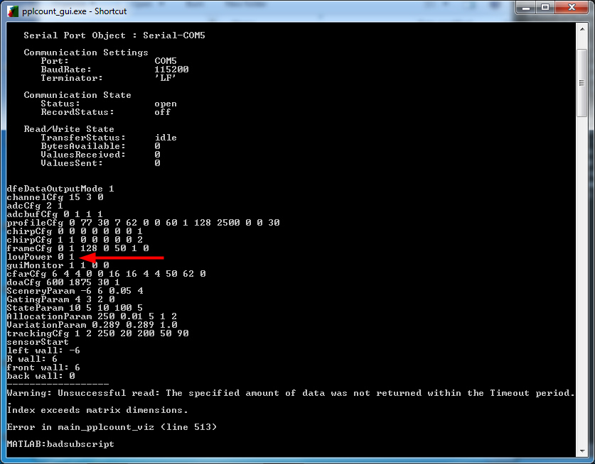

  • .cfg Power setting was update and uploaded to EVM.  Visualizer crashes.  Error messages and confirmation of 'lowpower' settings:
    What other steps \ actions should be tried to successfully run the people counter demo?
  • Hi Raymond,
    Did you power cycle the device before sending the configuration?
    Assuming that does not fix the problem,
    We need to determine if the device is sending any data. Do you have a Serial port interface like Tera Term or putty that you can connect to the serial port after the Matlab script crashes? A crash at line 513 is usually due to lack of data coming from the device. If you can connect to the serial port with something besides Matlab, we can confirm that there is no data coming from the device.
    Are you running the pre-compiled binary, or are you using a binary you compiled? This configuration works on my end with the pre-compiled binary. If you have compiled the binary yourself, there may be some error in the compilation process that is causing an issue.
    Justin
