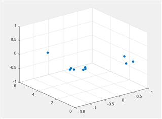

We are working with AWR1843BOOST and DCA1000EVM for recognition of gait.
We are able to generate the point clouds using the gui code that we have developed. A screenshot of one frame is shown as follows:
We want to generate the heatmap spectrum of the same.
Another question, what should we define the tlv type for the Azimuth heat map...!
Could you please help us with this.
Thank you.
Vipul
    In order to generate the heatmap you would need to compute 2D FFT accross all the chirps.
    Please use as reference the documentation for the SDK mmwave demo.
