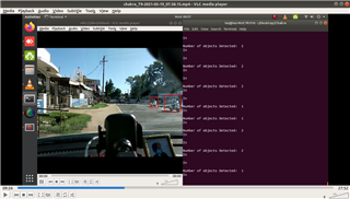

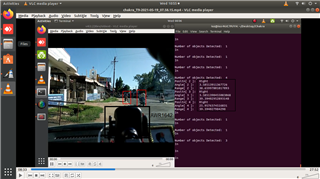

    As suggested by you, I have mounted the radar on the car dashboard and I had tested today on road.
    Following are the observations:
    Objects like Motorbikes and humans are mostly not detected and I also Observed few False Positives(when there are no objects on road, AWR1642 detects something as an object with range and angle)
    Please find the attached images as described above:
    False Positive
    In the above picture range and angle do not match with the objects in front of the RADAR on the right hand side(Host Vehicle is Idle)
    In the above picture, vehicles on the right hand side not detected
    In the above image, the person is not detected(but the RADAR had detected the same person in the previous frames, but its not continuous)
    In the above picture, the Car and the person are not detected(Host Vehicle is Idle)
    Please note, we are using a python code for getting the data from AWR1642BOOST, Can you please let me know, if mounting the RADAR on the car's dashboard obstructs the radar from detecting objects? , Do I need to increase the height of the mount with a little front tilt?

    Sometime the detection may not be continuous due to other objects in the environment.
    Also, I think there will be some attenuation from the wind shield.
    Detection of moving objects should be much better.
    Are you running SRR/USRR mode?
    Can you please try to place the EVM outside the car and check if the performance is different?

    Now, I understand attenuation from the wind shield could be a reason for objects like motorbikes / pedestrians not detected from inside the car.
    As you advised, we will mount on the pumper, test and share the results with you.
