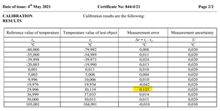

We want to used TMP117 (YBG) as reference sensor. We sent five units to certified laboratory for verification. Each of five had increased error value at 20°C, 30°C or 37°C (see attached pic with results).
Before we send them back to re-verification I would like to make sure this error doesn't comes directly from TMP117. Is it possible that for certain temperature range the sensor may have significantly bigger errors?
